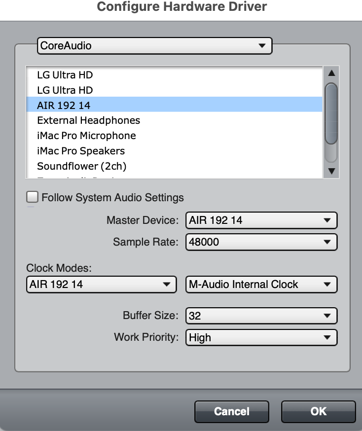

Make sure that your unit is set as input/output. With DP 11.1, Follow System Audio Settings defaults to On. Uncheck that box and see if that fixes you up. You'll see that I leave it unchecked.
- Screen Shot 2022-07-21 at 6.03.17 PM.png (102.17 KiB) Viewed 6799 times

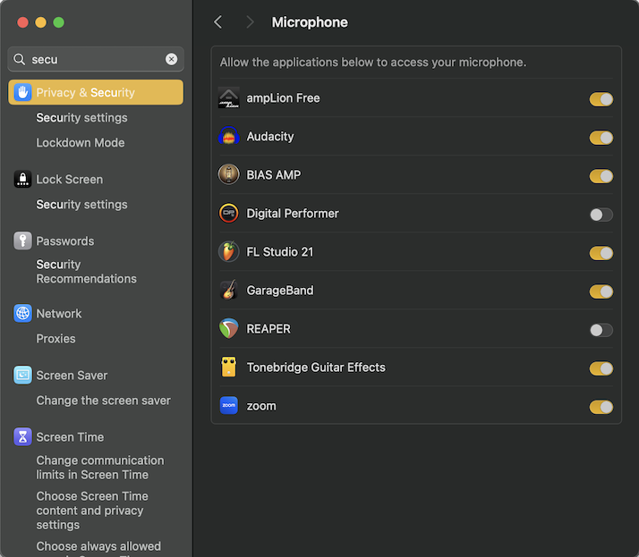

Also- set microphone permissions to “on” for DP!

and all versions of DP over MacOS High Sierra and later. It’s a MacOS, not a DP thing.

You bet, I recently reinstalled DP 11 on my new Mac Studio Ultra, and I did not enable microphone permissions during the install.
I tried to record through my Apollo a few days later, and it would not let me.
After a few stumped moments I realized that I did not grant input permissions on the microphone, which apparently applies to any audio input device!
You can adjust that setting on:
Preferences/security and privacy/privacy/microphone

The one thing with the microphone-permissions was finally the solution!
As i've seen there, a lot of my sound application did lost their permission (Kontakt, Sound Studio, etc.).
Seems to be OSX-Update-issue, i never got that problem before.

Dudes – just following up with this lingering issue (as of 12/23). This just saved me from the same dilemma. I had just switched to Sonoma, but didn't make the connection that a microphone security setting would mess up my DP setup. I tried my same Scarlett Solo in GarageBand and Audacity, and it was working, but not in projects I had fairly recently recorded in DP with the same setup. Man! Thanks for this.
