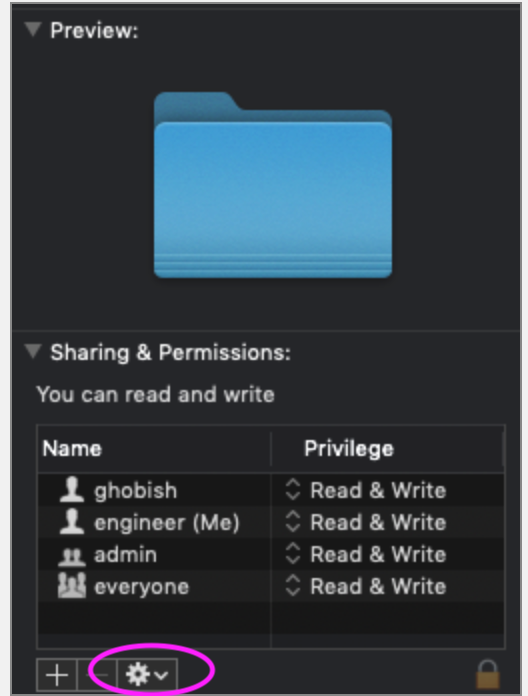

Apply to enclosed items or Make … the Owner. If both boxes are present, check Apply... and see if that does it. You'll get a confirmation dialog that you'll have to approve.
Highlight each User in turn. Click on the Settings I have circled in magenta. Check the box for DP 11.34; 828mkII FW, micro lite, M4, MTP/AV USB Firmware 2.0.1

I followed your suggestion for both "ghobish" and "engineer" (made owner of the folder and applied all changes) and am now able to unlock the file- thanks Mike!
