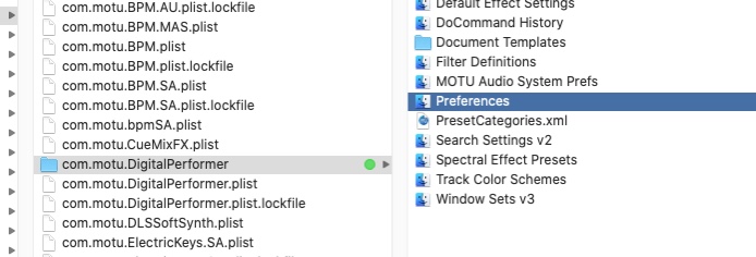

Since this seemed like a bug that would be very important, I reached out directly to someone at MOTU. They were not able to reproduce this, so their suggestion was to delete the prefs shown in the image below. If it still happens, maybe you can give a little bit more detailed description of it or perhaps a recipe for making this happen.

I did try deleting the Preference file as suggested but it did not help.
