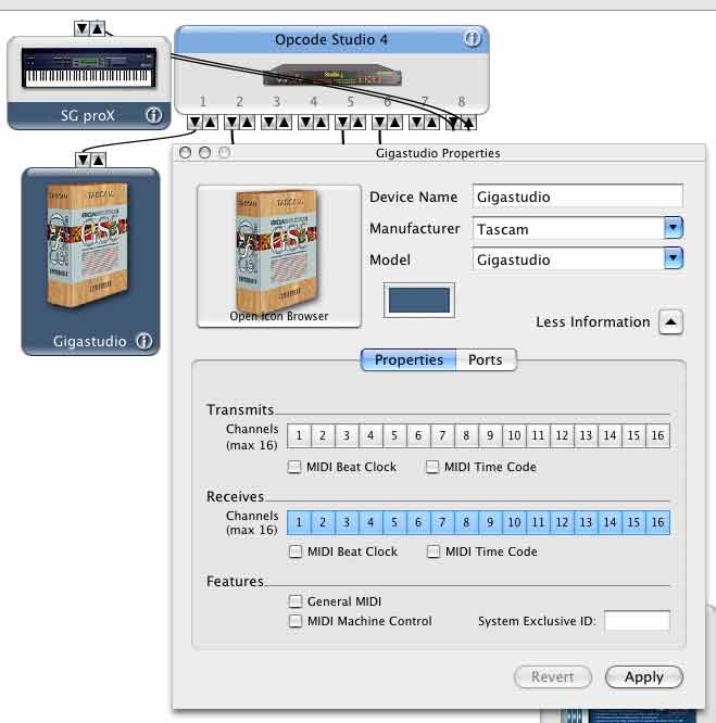

My set up: both machines have a MIDI interface.skan wrote:can you help me? i want to replicate that setup but can't work it out. i'm trying to work out how to connect my DP/Macbook/OSX rig to trigger my old SC2 card in my old G4/400.
OS X machine --> MIDI interface out ---MIDI CABLE---> MIDI interface in ----- > SampleCell machine.
Then in audio/MIDI setup on the OS X machine you create a SampleCell II device. (just like any other external MIDI module) Here is a picture from my Audio/MIDI set up (this picture is for my Gigastudio PC, but it is just the same kind of thing for my SampleCell Mac.
