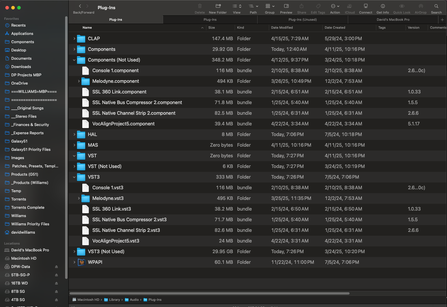

I'm having a huge problem with DP right now. It is essentially unusable. It won't launch. It won't launch in safe mode. If I trash the preferences it will rescan the plugins and then it will launch but will soon crash again and won't launch again. If I remove all the plugins from the folders it will scan and say it found a bunch of plugins. What the heck? How can if find AU plugins if the "Components" folder is empty? I hope someone can help me out with this problem. I'm so tired of DP's pitiful stability. If it weren't for the fact that it has a Tracks and Sequence Editor view, I'd be gone.

In your screenshot your VST3 folder still has plugins in it. Here anyway even if I'm using AU only it scans VST and VST3 as well if I trash preferences.

... and the Components and CLAP ƒ's as well.Michael Canavan wrote: ↑Thu May 01, 2025 5:00 pmIn your screenshot your VST3 folder still has plugins in it.
Re: DP Finding Plugins on Scan with Folders Empty & DP won't launch & crashing
I guess I haven't explained this very well. The picture is how I normally have it demonstrating I know where the plugins are stored and I even have them set up so it is all AU except ARA (Vocalign and Melodyne) and three that need to be VST3 to function property (SSL Native Compressor and Channel Strip and Softube Console 1) which in those cases I don't have the AU's loaded and only have those five VST3's loaded. I am saying that when I move all the plugins out of the components and VST3 folders so they are EMPTY, then trash preferences, then rescan plugins, DP discovers like 300 plugins even though the Components and VST3 folders are 100% empty... Therefore DP is somehow getting plugin information that may be causing it to hangup on start and crash. This is a very weird and not routine case.

OK yeah that's odd, I ran into a similar issue with Logic once and a AUv3 plugin that was hanging Logic.dwilliams wrote: ↑Fri May 02, 2025 9:25 pm I guess I haven't explained this very well. The picture is how I normally have it demonstrating I know where the plugins are stored and I even have them set up so it is all AU except ARA (Vocalign and Melodyne) and three that need to be VST3 to function property (SSL Native Compressor and Channel Strip and Softube Console 1) which in those cases I don't have the AU's loaded and only have those five VST3's loaded. I am saying that when I move all the plugins out of the components and VST3 folders so they are EMPTY, then trash preferences, then rescan plugins, DP discovers like 300 plugins even though the Components and VST3 folders are 100% empty... Therefore DP is somehow getting plugin information that may be causing it to hangup on start and crash. This is a very weird and not routine case.
It does seem like an incompatible plugin, what's the crash report say? BTW ChatGPT is pretty useful with crash reports, just feed in the main part and the crashed thread.
