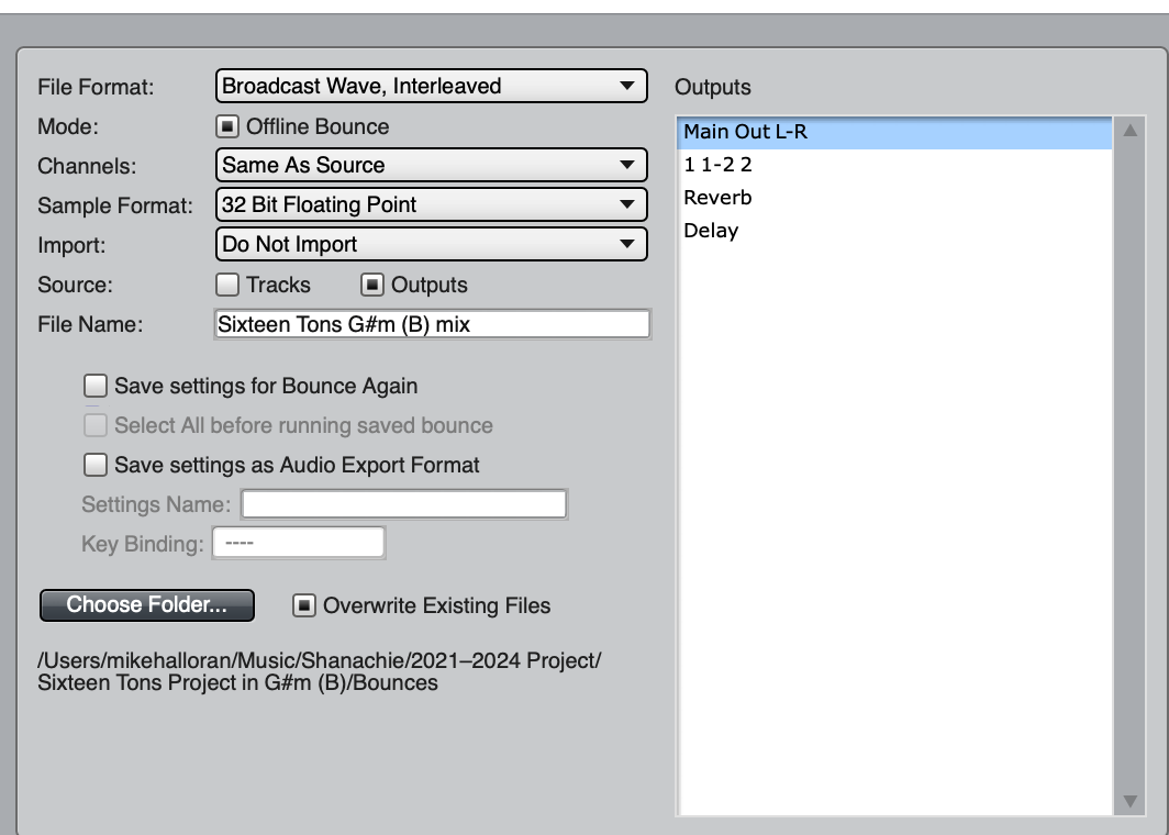

This works but I don't use it. No one asks me for 32bit floating point. Adobe Premiere and Premiere Elements crash (or did) when I tried to use those tracks. So, while I record and work in 32bit FP, I export 24bit.
- Screenshot 2024-12-06 at 9.18.57 AM.png (129.23 KiB) Viewed 4324 times

I wouldn't typically use Bouncing for a simple export of an existing single Soundbite. (Actually, I almost never use bouncing at all).
My workaround in this case was to just option-drag the files right out of the audio folder, so that worked.
