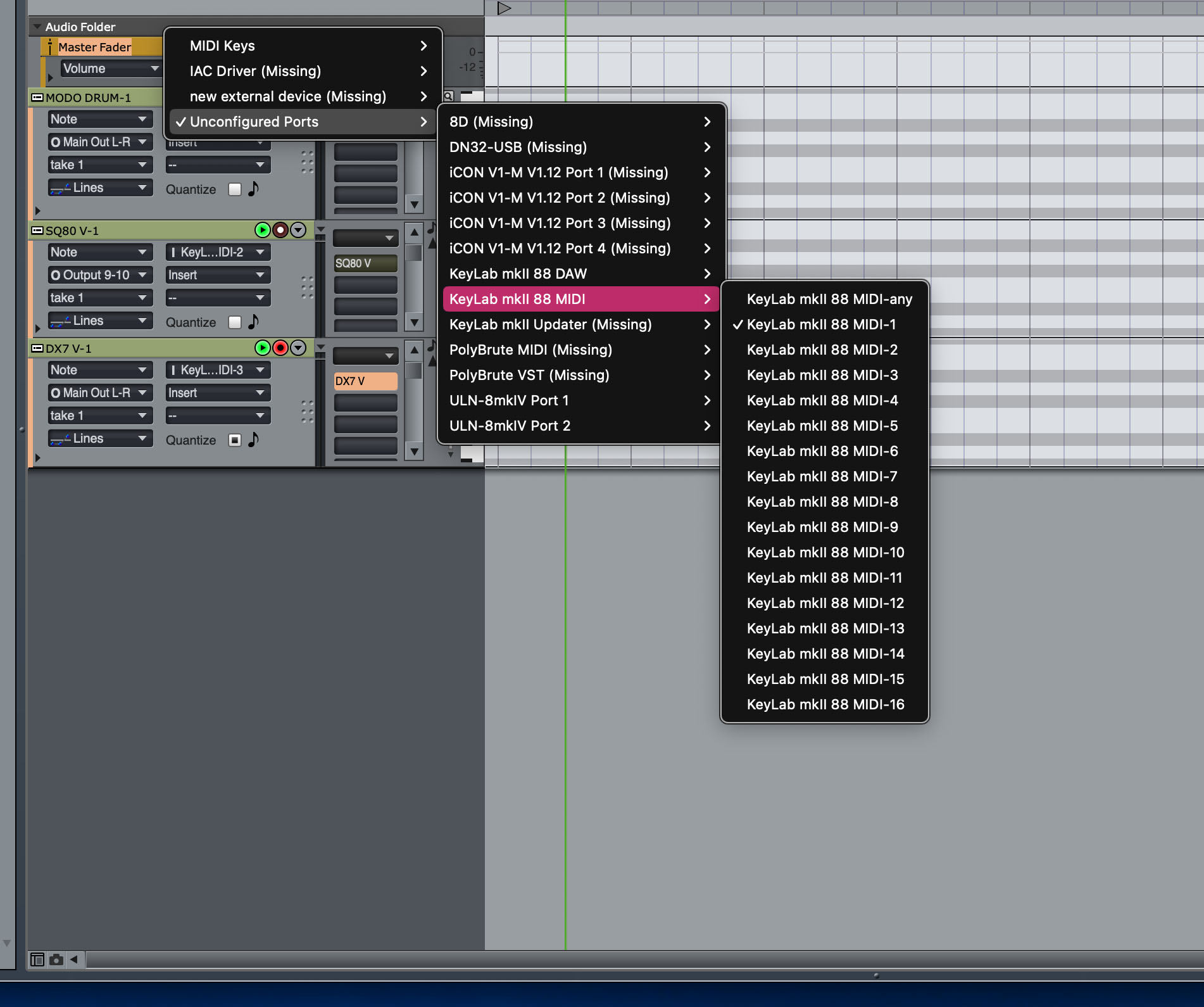

I'll admit up front, I'm something of a neophyte concerning MIDI since most of my recording experience has been done with audio going straight into the system .. And i recently got the MK2 to take advantage of Arturia's Inst. suite. But I can't figure out how to set it up where One Ch controls One virtual Inst. ONLY ?
They are all sounding together under a single key press even though I have each assigned to a separate MIDI ch ?

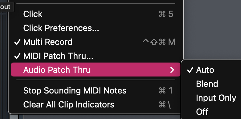

Do you have Studio>Multi Record on?

It is checked .. I'm assuming that means it is "On" ?

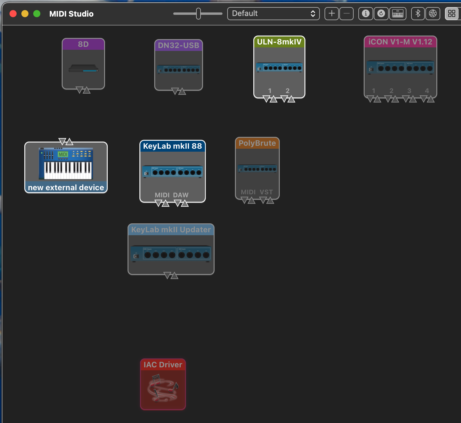

Screenshot 2024-08-12 at 1.03.00 PM.png (300.32 KiB) Viewed 2568 times
If You Can't Hear It .. Don't Go Near It !!

I'm just wondering why you are using MIDI Multi Record. I always run DP with MIDI Multi record OFF and Audio Multi Record ON.
Unless you want to record multiple performances to multiple VIs simultaneously, I'd just turn MIDI Multi Record off. That way, any and all connected MIDI Controllers will address the current record-enabled VI. You don't have to specify the MIDI Input Source. You can use the Mod Wheel on one keyboard while playing notes on another and manipulating an Expression Pedal connected to a third; all will impact the record-enabled VI.
With this approach, make sure MIDI Controllers are not spitting out notes on multiple MIDI channels; if so you will get doubled MIDI recordings. And working the Mod Wheel on two keyboards at once will give weird, jumpy results!

In the image showing the available sources, we see three versions of the KeyLab MkII: DAW, MIDI, and Updater (missing). However, it shows ALL of them under the heading "UNCONFIGURED PORTS".
So that might be a good first step, to go into Audio MIDI Setup (AMS) and double-click device KeyLab MkII. Then in the edit window that opens, switch PROPERTIES to the PORTS tab. It looks like it would (should?) have two ports, one called MIDI, and one called DAW. I'm guessing the MIDI where the KeyLab's 5-pins in/out are treated like a separate port on the same device. And that DAW is the USB feeding the DAW (in). Not sure what the output of DAW does.
In the image showing Audio MIDI Setup, we see the DAW & Updater. I'm tempted to tell you to delete updater, as that just seems like some leftover something. Worst case, if it is needed, you could re-install drivers. The New External Device shows as missing. Do you know what that is? If you don't need it, you can probably get rid of it. Just adding an unnecessary item to the list.

HCMarkus wrote: Mon Aug 12, 2024 11:53 am I'm just wondering why you are using MIDI Multi Record. I always run DP with MIDI Multi record OFF and Audio Multi Record ON.
It was checked. I think either MOTU or Sweetwater activated that . Can't remember why. I unchecked it and am now able to record a MIDI inst while listening to another MIDI inst. YAY !!
