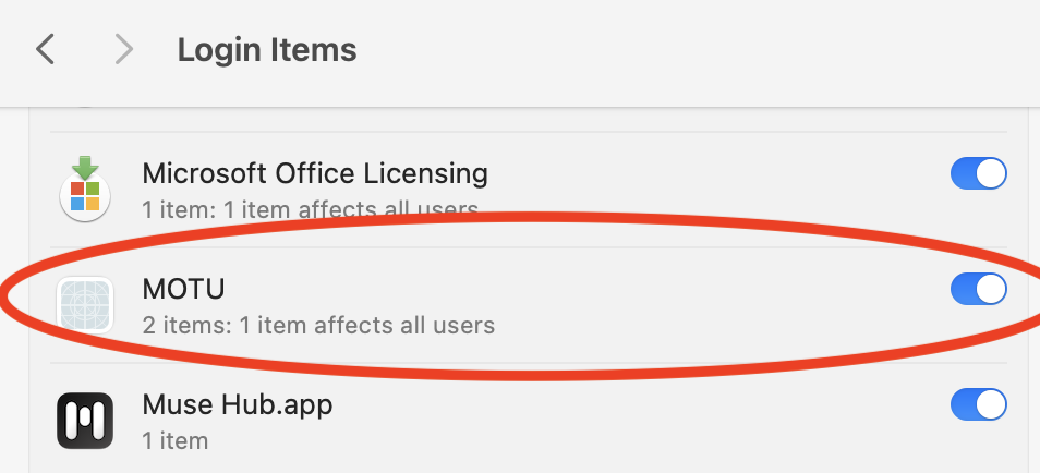

When I reinstalled the MOTU MIDI driver, the USB MIDI Extension notice popped up. I wanted to allow it before rebooting but Matt told me to reboot first, so I did. Wondering if that was my mistake the other times.
After rebooting, I went to Privacy & Security, allowed the extension, then opened Login Items and had to re-enable MOTU.
I rebooted again and it appeared in Audio MIDI Setup.app — along with my MTP AV USB and the com.motu.driver.USBMidiDext appeared in Activity Monitor as it should. This process had disabled my 828mkII but reinstalling that driver brought everything to life.
I'll decide later whether or not to keep one on those micro lites or the MTV AV USB. I can unregister the new (to me) unit if I want so that a buyer can register it. MOTU still allows this.
Declaring Victory for now.

Check my screen shots to make sure that the Activity Monitor and Login Items display exactly what I have highlighted. Enter motu in the Activity Monitor Search field to display only the those. If it appears in Login but is turned off, turn on and reboot.
If only one or neither appear...
Go back to the earlier posts to see the list of everything that must be deleted. Shut down and reboot before reinstalling the MOTU driver.
During the driver installation, you should get a prompt to add the driver in Security settings. Do not do this yet—apparently, that was the mistake I was making. After Reboot, then you go to Security and Privacy to add MOTU. Reboot again.
Now Activity Monitor and Login Items should display correctly. Again, if MOTU is turned off in Login, turn in on and reboot.
