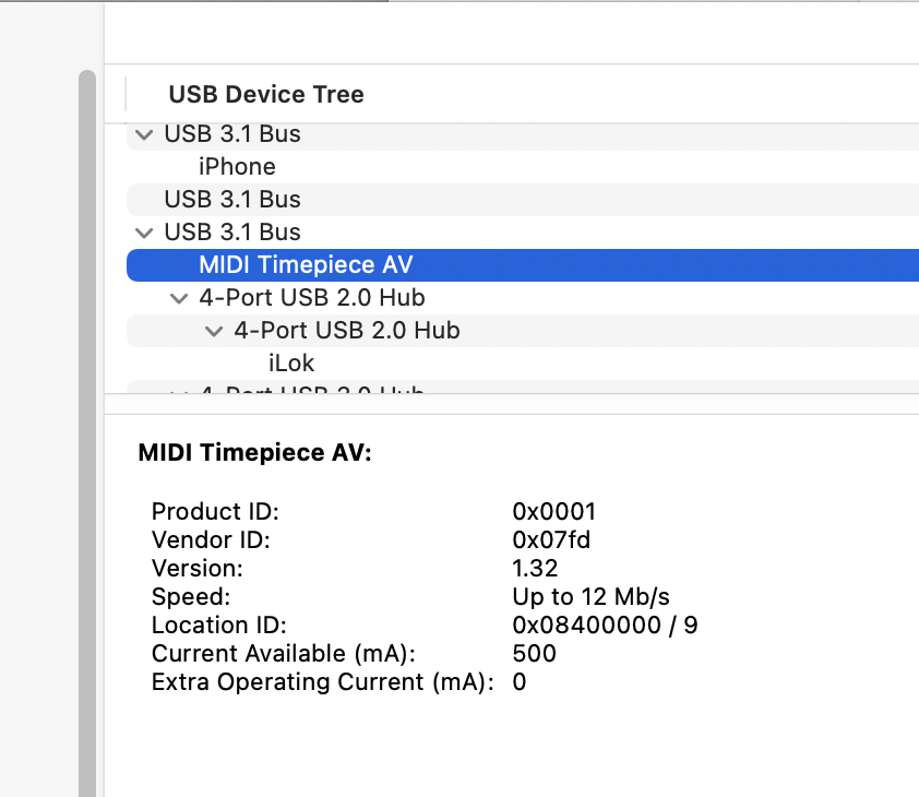

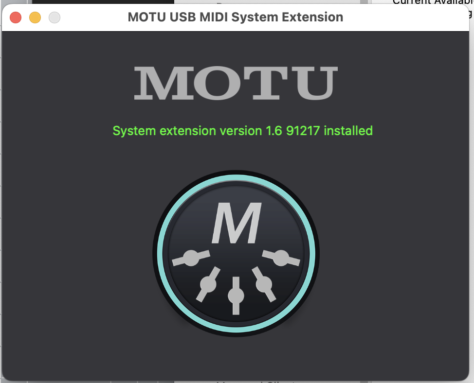

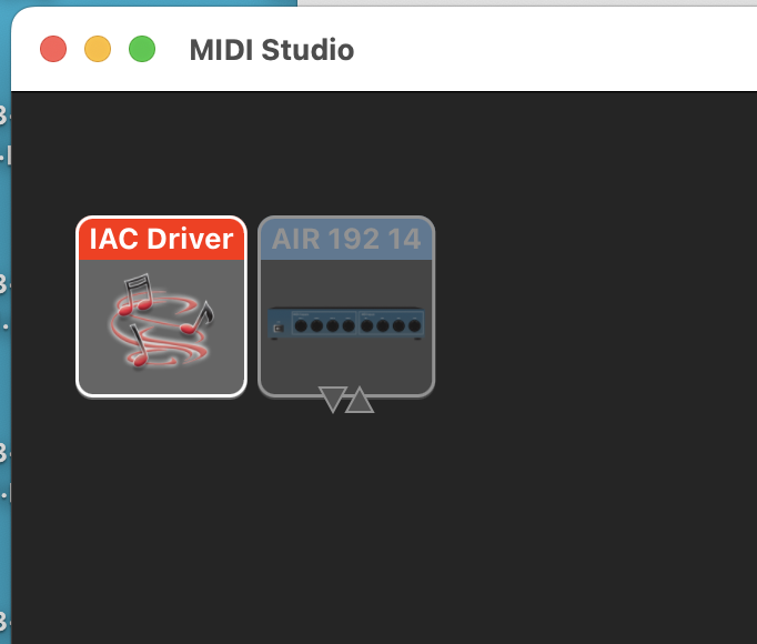

Long talk with MOTU Support on another issue and brought this one up. Verified that I have the current MOTU driver and that it is loading properly. My Mac sees the MTP AV but the driver does not. He said that there can be some driver loading issues but that it appears not to be the problem with my setup.
Since my unit is long past support, there was nothing more he could do but assured me that, if I bought a current unit and it didn't appear, I could schedule another call and MOTU can try some of those tricks as necessary.
