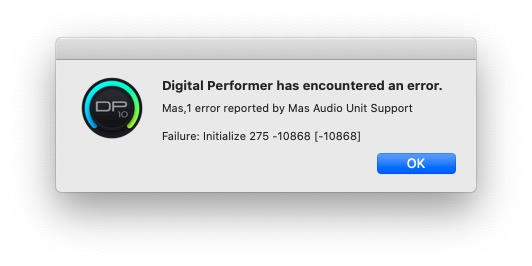

HI, all. I recently bought Komplete 14 Standard and I use it with Digital Performer 10.13 on a 15", mid-2014 Retina MacBook Pro running 10.15.7.
I've used Guitar Rig Pro 6 for a few pre-recorded tracks on my solo gigs and everything has been working great until this past weekend. I've been getting the attached error, and when I Google it, it seems to have something to do with a known bug involving Guitar Rig and running in stereo. I run my show in mono, and like I said, it was working until it wasn't.
I deleted the plug-in component file and reinstalled Guitar Rig from the Native Access app. Digital Performer scans all audio plugins at startup, and everything passed. Still doesn't work.
Any ideas? Please let me know if there's any other info I should provide., and thanks in advance!

So... I have GR 6.3 and that's the last compatible version under Catalina, apparently. There a 6.4 update that claims to have resolved some known issues with DP, including my issue. So... I'm not sure what to do.
My MBP can go to Big Sur, although that worries me . I've been using Catalina since its release and this machine has been rock solid with DP at home and on gigs. I also don't know if my Ultralite Mk3 (the original) will continue to work if I upgrade to Big Sur and DP11.
Anyone have any experience with this combo of hardware/software?

I missed that you were running Catalina. According to NI:
https://www.native-instruments.com/en/s ... &t=updates
Your UltraLitemk3 uses the MOTU Audio Installer. You won't find the Big Sur driver on that download page because the unit is no longer supported but you will find it by going to the 828mk3 Hybrid page. Download this
I don't see anything for GR 6 on the Legacy Updates page, only GR 5:macOS 11, 12 or 13 (latest update)

I think I found the issue over in the NI Support boards.mikehalloran wrote: ↑Mon Sep 25, 2023 10:36 am I missed that you were running Catalina. According to NI:
Native Access has been updating many VIs to versions that require Kontakt 7.6 even if the users do not have it or their OS cannot run it. So far, the answer is to be running K 7.6 — which misses the point completely. There are links for rolling back many VIs to earlier versions but I don't see that Guitar Rig is on those lists. They do recommend yuu contact Support if you fall through the cracks.
Lots of handwringing and opinionizing that NA shouldn't have to be expected to make this distinction.
Funny—Microsoft Auto Update knows to give an error message if your OS is too old to run the latest updates to Office (as yours is, BTW) and won't install the latest in that case. MS also makes all legacy updaters available for download—as I have a cottage industry maintaining 2012 MacBook Pros, I use that resource a lot. I think every school teacher in the Silicon Valley bought one and the word is out that I know how to fix and upgrade them.
