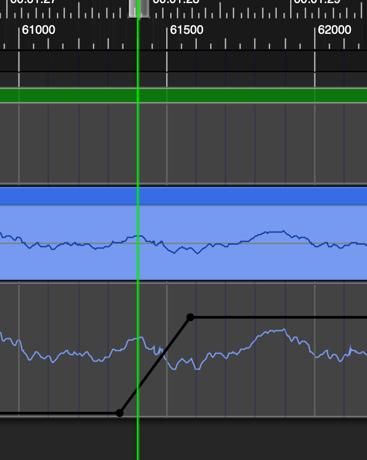

Re: How do you do instant (no ramp) automation changes
Makes a fast ramp but not a vertical ramp. (Entering a value doesn't work if the transport is running -- a ramp is produced back to an earlier spot, but clicking the fader does) But it sounds fine. Why a completely vertical ramp anyway? Doesn't that create clicks and pops?
- Ramp.png (67.38 KiB) Viewed 1182 times
