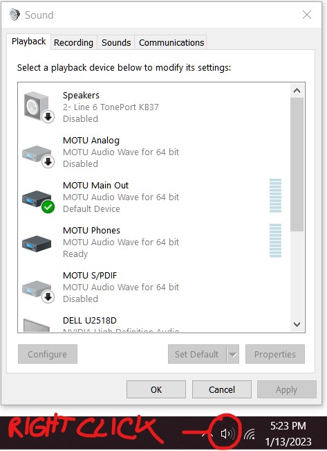

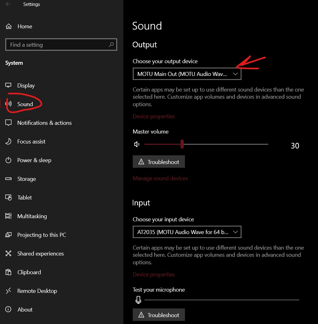

I just saw your post. Have you found a solution? It's been awhile since your post, but just in case, I would suggest you take a look at Windows' Sound Settings to ensure the MOTU's Main Outs are selected. I attached a screen shot.
You can also access that function by right-clicking on the icon that looks like a speaker on the taskbar, and selecting Sounds. The interface is different from the one above, but the advantage is that you can do a lot in a compact UI.
- SoundSettings01.jpg (112.47 KiB) Viewed 1150 times
- SoundSettings02.jpg (63.07 KiB) Viewed 1150 times

No I haven't figure it out. I did what you mentioned in your reply with no results.

I have changed the sample rate from the windows settings. That was the reason.
