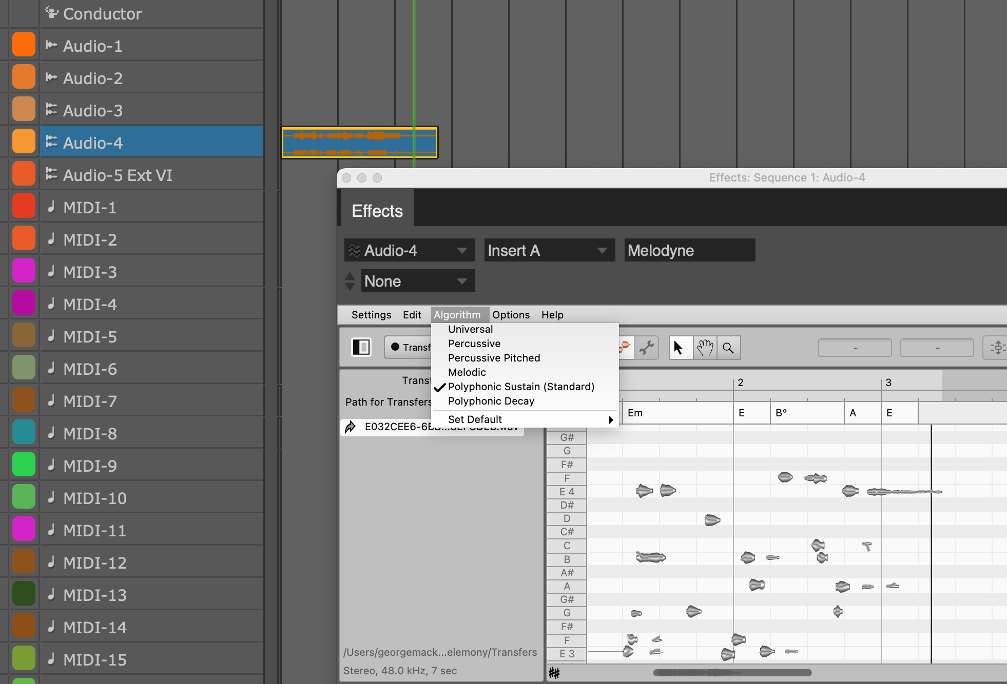

Oh! Does this free version of Melodyn had polyphonic editing, and their Audio to MIDI implementation? I thought that was only on the flagship version. That is definitely something I would use.

Yikes. Good point. Probably not. I used my Essential license to pay upgraded price to the next step up with does polyphony.

Re: DP 11.2 Melodyne Integration
EDIT: It displays polyphony, but does not allow editing. Sorry if I misled. From the Essentials manual:
"In Melodyne essential and assistant, of course, you can only see the notes of polyphonic instruments, displayed as gray blobs. With the editions Melodyne editor and Melodyne studio, on the other hand, can you also edit the polyphonic blobs and change, for example, the G of an E minor chord to G# to obtain a chord of E major."
Yes, it does polyphony:
- Screen Shot 2022-09-21 at 1.58.42 PM.png (366.58 KiB) Viewed 2911 times
