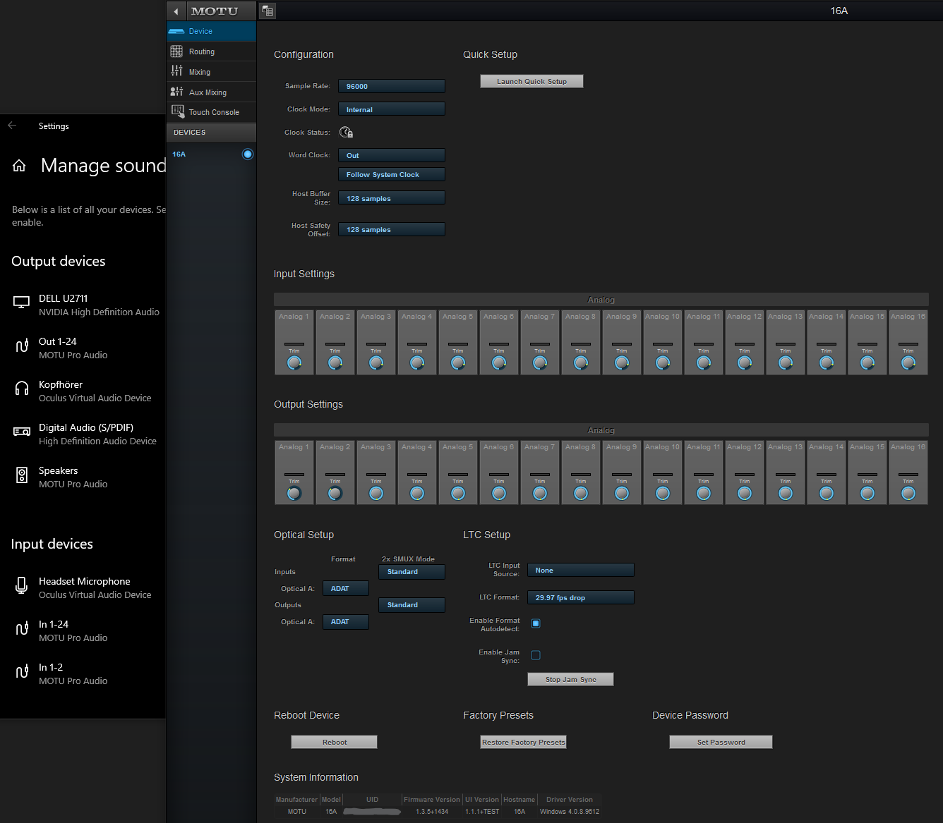

Yes it does, but in a weird way. I get two sets of outputs and two sets of inputs:
"Speakers" (outputs 1-2)
"Out 1-24" (outputs 1-24 out of 16, bundled into one weird multichannel thing)
"In 1-2" (inputs 1-2)
"In 1-24" (inputs 1-24 out of 16, bundled into one weird multichannel thing)

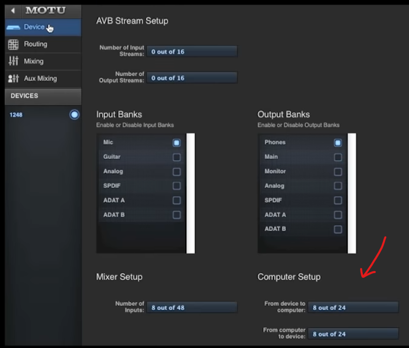

The youtube shows a part of the UI that I don't have: "Computer Setup". I'm attaching screenshots of both for comparison. Any ideas are welcome.
Youtube:
Mine:
I've tried all sorts of different routings, which all works quite well in ASIO, but WaveOut / MME doesn't seem to reflect these changes at all.

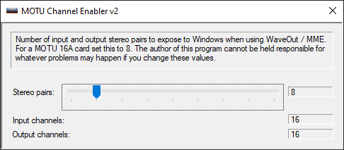

Enabling all inputs and outputs on Motu 16A
I've made a tool to make it easier for Windows users to get access to inputs and outputs 3 and up (when not using ASIO). I hope this helps someone.
https://www.robotplanet.dk/audio/motu/M ... nabler.zip
It simply sets the above registry key. If you set the slider to the lowest value, the added key will be removed (which is the factory default).

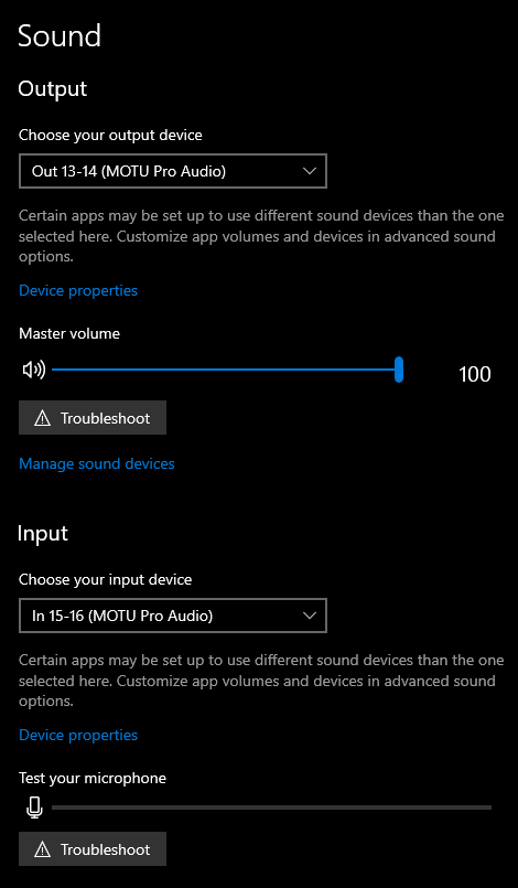

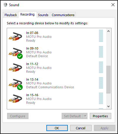

After using the tool, you should have access to all inputs and outputs in Windows control panel, like this:
Tip: If you rename the inputs from "In 7-8" to "In 07-08" the leading zeroes will sometimes cause the inputs and outputs to be sorted correctly. Without renaming they will most certainly always be sorted wrong.
