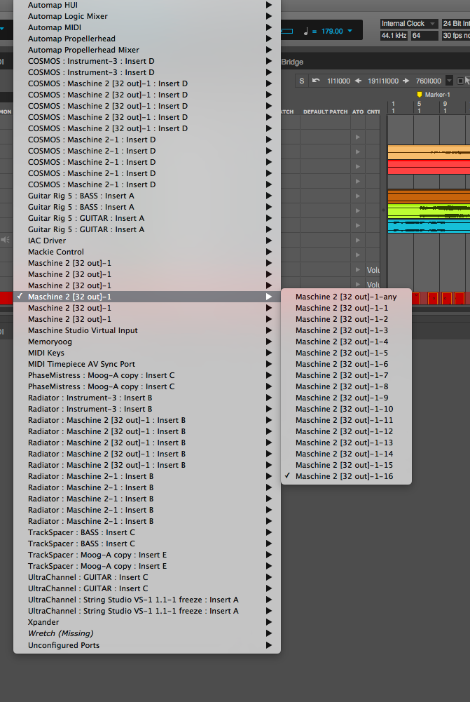

A picture is worth a thousand words they say. VSTi out is MIDI, virtual MIDI from the plug in. These are what's being relentlessly copied.musicman691 wrote:I'm a little confused - do you have two issues? I know you wrote about the tripling of MIDI entries earlier.Michael Canavan wrote:VST, AU as it stands doesn't send MIDI out from plug ins, this is needed with Maschine to set up Scene firing. ElCapitan, latest everything, except DP as of now.. I'll talk to MOTU tech about it, phone calls are quicker. It works really well in 9.01 BTW, and because AU is crippled this way it's something Logic cannot do.musicman691 wrote: Ouch. Are you using vst or au format plugins? And what version of OSX?

For fun I threw Geist, another VSTi that sends MIDI out and it also triples the input. <--- Sorry about that mistake earlier, it's the input selection for a MIDI track where 9.02 triples or more a VSTi, which makes sense in terms of it being an issue since that's what's different about a VSTi that can send MIDI out.
Trackspacer for instance in that list is not on a track that Maschine is on.
Doesn't let Maschine off the hook though, as NI have a Virtual MIDI input/output driver obviously, that shows up in the Input and Output list in DP whether Maschine is instantiated or not.

There are only a few VSTi's that output MIDI to the host, Reaktor can, so load an instance into a V-Rack and see if the VSTi repeated a couple times. I get three without Maschine loaded into the DP project. Also, when I delete the instrument, the repeats stay, I'm left with two Reaktors in my Input for a MIDI track. If I recall Reaktor into the instrument track I get more than three repeats(ghost inputs).musicman691 wrote: Not seeing that but then again I don't have Maschine but I do have a lot of other NI stuff (Komplete 9). Do you have any way of trying this on a different OSX version? Could be an El Crapitan issue.
I would definitely appreciate it if you loaded an instance of Reaktor 5 and let me know if you have the same issue. Curious to know if this is a bug on my system or a global one?
