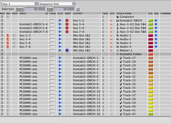

Hi.
I think I understand what you want to do and it's not necessary to go outside of the computer at all. Kontakt2 has 16 outs and all of them can be routed interally and recorded without cables, bouncing, freezing or anything else.
Check out the picture. In the picture, I've created an instance of K2 and called it "Kontakt2-ORCH". I've created three Aux tracks for the other three stereo outs that I want to use from Kontakt----this gives me four stereo pair outputs from K2. You can see the inputs on the Aux channels are Kontakt2-ORCH 3-4, 5-6, 7-8. Then you see that the outputs of those channels are sent to busses: 1-2, 3-4, 5-6, 7-8. This keeps them all split. Then we'll bus those Aux outputs internally into 4 audio tracks. Record enable those 4 tracks and you're set to record. This will allow you to record four stereo pairs inside DP without anything from the outside world.
If you put audio plugins like verbs, eqs, comps and limiters on the inserts of the Aux channels and the main K2 instrument track, all that will get printed to the audio tracks.
And you can continue to monitor everything because the audio tracks that are recording everything are still routed to your monitor outs. In my case, I have a Mobile IO (Mio Out 1&2), so the audio tracks are routed to Mio Out 1&2. In your case, you'd send it to the Traveler. If you want to hear what's going on without being record-enabled, you can enable the monitor feature (MON). It's the little speaker icons that light up blue when clicked. They'll pass audio without having to have the track record-enabled. You can leave them Monitor-enabled until you're ready to record, then just record-enable the tracks. (If you were working this way, you'd probably want to SOLO EXEMPT the audio tracks so they continue to pass audio when soloing stuff.)
Hope this helps.
Cheers.
-gabe
Hope this helps.
Cheers.
-gabe
Gabe...that is IT!!!!!
IT WORKS!
I just needed an illustration like that to map it all out. I don't use aux tracks and busses (in DP) in my normal studio because everything is cabled to the digital mixers. This is my first experience on a "laptop only" set up so I was in need of your illustration, which has cleared up a lot of confusion.
...now, do I send the Traveler back to the dealer??!
Can't believe it finally works...with no cabling or even an outside box of any kind.
IT WORKS!
hehe...yay!RobKral wrote:
IT WORKS!
This internal bussing method is how I do all my final mix downs. I have a huge template and I do everything in the box, so I route all the channels using busses ultimately into a stereo track and that becomes my master mix. I don't trust all the offline bouncing stuff. For me, I want to hear the track as it gets recorded......
As far as The Traveler is concerned.....it gives you a LOT of production flexibility---way more than just the Mac itself......I think it's the kind of tool that can really come in handy.....it's bus powered, has mic pres, different types of inputs/outputs.....If you ever find yourself out in the field, it will be VERY useful----you want to record someone and have to go to them----just grab the Traveler and the laptop (and a couple mics) and run. Or if you ever have to go to a studio....just bring the Traveler and the laptop and you can go in and out of the studio. There's a huge value in that. I have a Mobile IO which is similar to the Traveler in terms of features, and it's been the GREATEST tool when I leave my studio. if you can afford to keep it, I would.
Anyway, glad it worked!
Cheers.
-gabe
Yes, all good points. I'll be keeping the traveler.
But I can't tell you how helpful your post is. I looked again at the manual (motu mac group had someone sugest I RTFM (with a
) and I had, and have just again, and I jsut can't see that it's really spelled out. Your screen shot was all I needed, but needed it badly!!!
