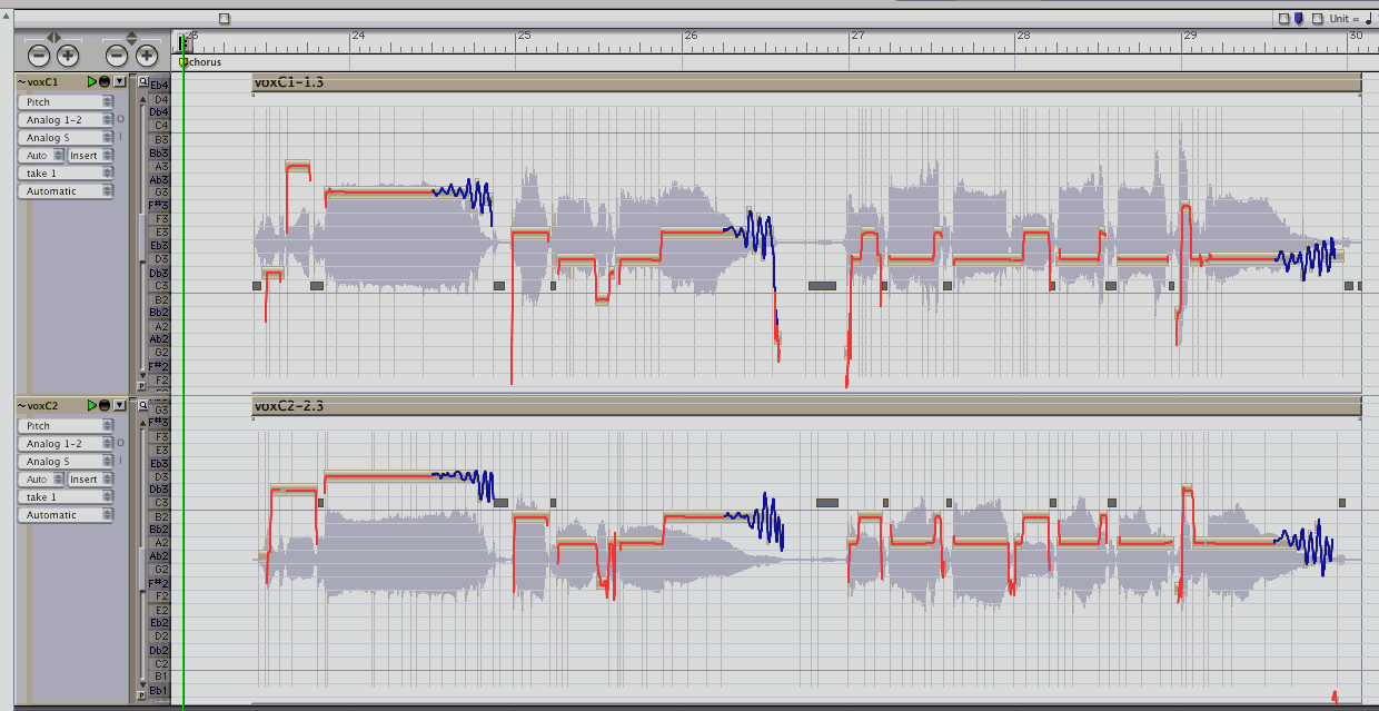

Pitch automation is a major kick in the creative pants! Here is my excercise from last night.
I wrote this chorus for a female voice, then tried to sing it myself for the demo. The notes are a bit out of my range, and I sang it very poorly. Judge for yourself:
http://superconductormusic.com/pub/unicornation/bsrs-nopitch.mp3
Then I used DP 4.6's Pitch Automation to fix my bad vocal. See screenshot:
http://superconductormusic.com/pub/unicornation/pitch.gif
Becuase this chorus is about voices from outer space, I option-dragged the pitch curve totally flat, so all variation was removed. Then I quantized the pitches and manually cleaned up where needed. Finally, I restored the vibrato at the end of each phrase by selecting that part of the pitch curve and pressing Delete. So simple!
Here is the fixed chorus:
http://superconductormusic.com/pub/unicornation/bsrs-pitch.mp3
The quick, robotic snaps between notes are great here, becuase of the song's outer space vibe, and are totally intentional. It's also easy to leave the transitions between notes sounding very natural. Some audio artifacts are easily audible when the voices are soloed, but with the huge wash of reverb from DP's Plate plugin, you can hardly hear the artifacts.
