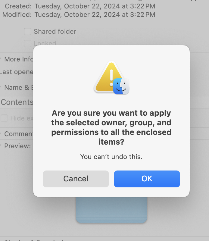

It occurs to me that this may be a macOS issue. Sequoia hosed Permissions for many, myself included. This caused most of my apps to stop working. Apple Support and I took nearly a month to rectify this. I figured this out, not they and yes, they paid me for my help.
DP Plug-ins are stored in /Applications/Digital Performer.app
Right-click on Digital Performer.app and select Show Package Contents
Run Get Info, click on the padlock and enter your Admin Password.
System should already be Read & Write — if not, change it (if it doesn't say Read & Write, you have found the problem).
Leaving it highlighted, now click on Apply to enclosed items...
When you get to the next screen, click OK.
See if it works now.
I'm still running into apps I've not fired up in awhile and have to re-set Permissions through the path to re-enable them.
