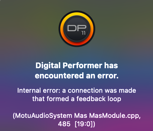

Here’s a problem with bussing that’s intermittent and vexing when it manifests:
I often set up six or more busses in most DP Projects. I use some for side-chaining. If you do as well, you probably know that you can get a feedback loop error message (See attachment.) if you select as a Bus Send the same channel that you have selected as a Side Chain input on an effect on the same Channel Strip.
What I’m seeing occasionally is that error message when I”m 100% certain I do not have a feedback loop.
I have been able to fix this in the past on occasion by deleting the bus or busses that seem to be the problem, and then add new and different busses (like 63-64 instead of 9-10), and re-route my effects. But, on a few occasions, no amount of deleting and adding new buses and selecting them for the side chain eliminates the error.
I’ve tried Loading my Project into a new Project, and that doesn’t solve the problem. That’s been a pretty reliable fix to corrupt or problem projects in the past.
I suppose this is a bug, and not a complaint.

It just happened to me again on another project update. However, this time, rather than assign a bus to a compressor side chain first, then assign a channel to be a Send, I did them in reverse order and did not get the loop error message.
So, not a solution, but maybe a workaround to a definite bug.

James, were you doing anything with I/O settings when you got the message, or did it just randomly appear. I have found that I will sometimes (but rarely) get a false feedback loop message when I change the I/O in the Tracks window. It's as if the new settings haven't landed in their final destination yet, if that makes any sense. It usually quickly goes away, but on the rare occasion that it persists, closing and re-opening the project fixes it. If it doesn't fix it, it's because I've done something stupid and the error is real.
Also remember that your sends can sometimes be the culprit as well.
