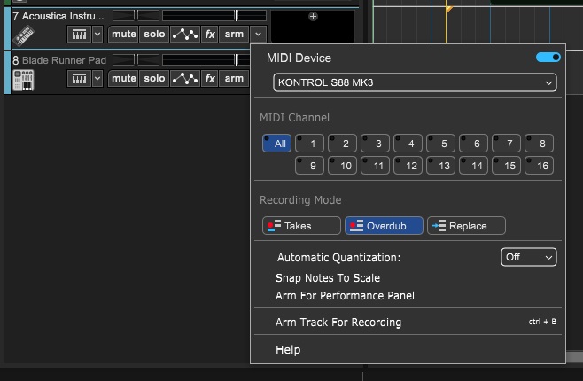

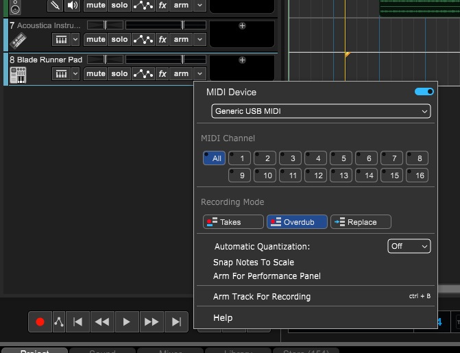

Background (Windows 11):
I have a KORG PA5X that I often use just as a MIDI only keyboard. And, I have a NI S88 MIDI only keyboard. In Mixcraft 10.x this is very easy to perform, select the Instrument and then select the MIDI keyboard from a dropdown on the track - super simple and fast. In the case of my KORG it registers as "Generic USB MIDI" and the NI S88 registers as "KONTROL S88 MK3" as seen here:
Here are my MIDI keyboard selections:
Track 7 NI S88 Track 8 KORG (Generic USB MIDI) In DP, I Add a Instrument track, Add a MIDI track, on the MIDI track associate the MIDI track to the Instrument track. However I can't find how I assign a specific MIDI keyboard. This is a problem because I want to have one keyboard (KORG PA5X) be the source for a specific MIDI tracks and the NI S88 to be the source for other MIDI tracks. As it stands right now the both play on ALL MIDI tracks ... not good.
To be continued ...
To be continued ...

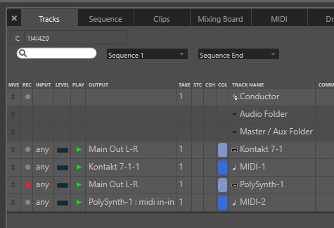

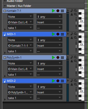

Here is how I have DP setup:
Tracks Sequence Going thru the tutorials and other DP videos this is how they seem to setup MIDI controllers to be the input for an Instrument track. In Tracks tab the INPUT column is always "any" and I can't seem to change this to my specific USB MIDI controller?
I must be doing something wrong, Mixcraft is a lot cheaper than DP and it was very easy to setup, so I gotta be missing something basic in DP?
Suggestions?
Cheers, Rob.
Suggestions?
Cheers, Rob.

This is an easy one, fortunately.Rob Ainscough wrote: ↑Tue Jul 02, 2024 9:33 pmGoing thru the tutorials and other DP videos this is how they seem to setup MIDI controllers to be the input for an Instrument track. In Tracks tab the INPUT column is always "any" and I can't seem to change this to my specific USB MIDI controller?
Go into the "Studio" menu in Digital Performer in the main menu bar and then choose "Mutli-Record.' Now when you click where it says "any" in the INPUT column in the Track Overview (or where it shows "any" in the pop up menu in the Sequence Editor) you can choose the MIDI Controller you wish to have target that track and it will ignore other sources.

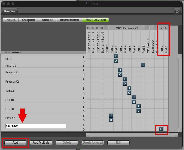

If that is cumbersome, what you can do is open the Bundles window (Shift + U) and click the "MIDI Devices" tab (in green). Then click the "Add" button at the lower left. Then you see in the red box at the upper right, that's my Komplete Kontrol keyboard. Just hard to read because the name doesn't fit. But you see Port 1 and Port 2 columns. Click on the square where the "O" (for Output) row of the MIDI Device you added intersects with the column of the MIDI controller keyboard. You can also click on it and give it a better name. (See red arrow.)
After you do that, you should see your MIDI controller keyboard with the name you gave it appear in the Input column in the Track Overview like below:

Wow, thanks for all these great comments and help. I’ll get this setup on return from the office … I did manage to find a Sweetwater article that says use Bundle … I didn’t know that Bundle existed.

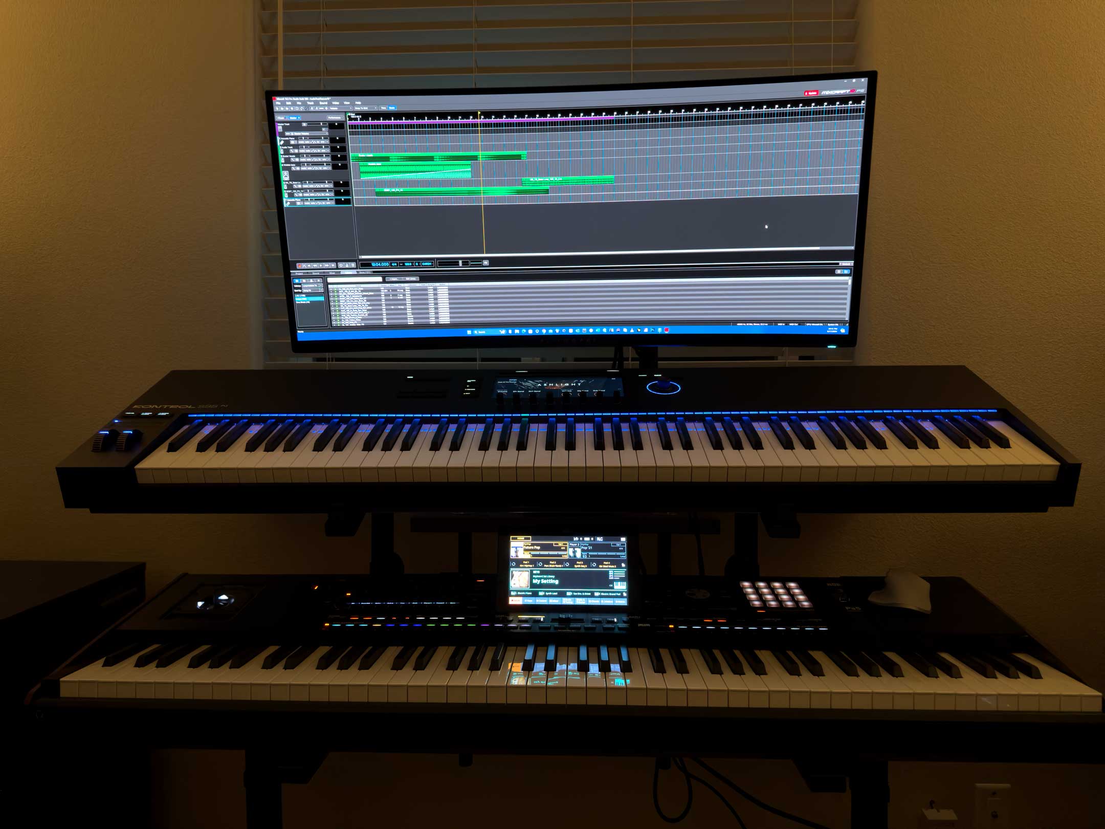

As far as talented Keyboardist … don’t consider myself that but I’m able to bang on two keyboards while recording

Well, in the example I gave, setting up a Bundle is optional. And don't feel alone. A LOT of people don't really know bundles exist at first. Digital Performer is a very deep program and it also comes with a lot of baggage since it's arguably the oldest sequencer/DAW around today.. You don't need to make the bundle like I described, but it makes it easier to choose your MIDI Controller from the menu in the future.Rob Ainscough wrote: ↑Wed Jul 03, 2024 8:51 am Wow, thanks for all these great comments and help. I’ll get this setup on return from the office … I did manage to find a Sweetwater article that says use Bundle … I didn’t know that Bundle existed.
Nice setup!![/quote]As far as talented Keyboardist … don’t consider myself that but I’m able to bang on two keyboards while recording

Thanks for all the input. Bundle is working great!
