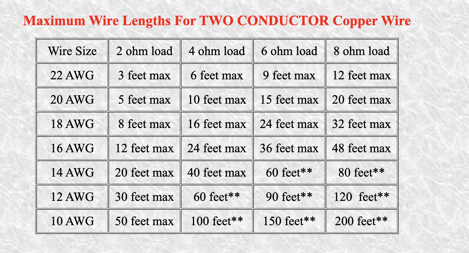

As one should be. it's only an issue if the gauge is too small, say 18 or higher. Which of us would use anything that small once we got out of our college dorms?
There's an old chart from Roger Russell's ancient article debunking the "boutique cables" myths:
http://www.roger-russell.com/wire/wire.htm#conditioner
For those not wanting to read the whole thing (again?), here's the chart by itself:
I have been using 12 Gauge low Voltage outdoor lighting cable for decades. Easy to buy by the foot at my local hardware store.

Enjoyed it, Phil. And the chart presented by Mike is great for Passive speakers.Phil O wrote: ↑Mon Jun 24, 2024 9:56 amWith passive speakers (8 ohms or less) I've heard arguments that the issue is resistance of the cable (not inductance or capacitance). But I'm skeptical.James Steele wrote: ↑Sun Jun 23, 2024 11:31 pm I heard the same thing about speaker cables... that is from a power amp to passive speakers.
For example with an 8 ohm speaker, 0.98 ohm of resistance in the cable would result in approximately -1 dB (1 dB of attenuation). 16 gauge stranded copper wire is around 4 ohms per 1000 ft, which means that 245 ft of wire is about 0.98 ohms. Speaker wire is two conductor so we're talking about a 122 ft cable being about 0.98 ohms. That means a 122 foot difference between cable lengths results in 1 dB difference between speakers (varies a little with overall length).
To me that seems like an unlikely scenario, and it's only 1 dB.. Just sayin'.
I haven't worked out the math for inductance and capacitance (if someone else wants to, have at it) but I'm guessing if anything they play a larger role, but again we're talking about the DIFFERENCE between cable lengths, not the overall length of each. In a studio setting, I can't imagine it being a big deal.
I'll get off my soap box now.
I think it is important to keep in mind James is working with a Line Level output to a high impedance input (his new ACTIVE speakers) in which case the nominal resistance of a cable is a non-issue.
