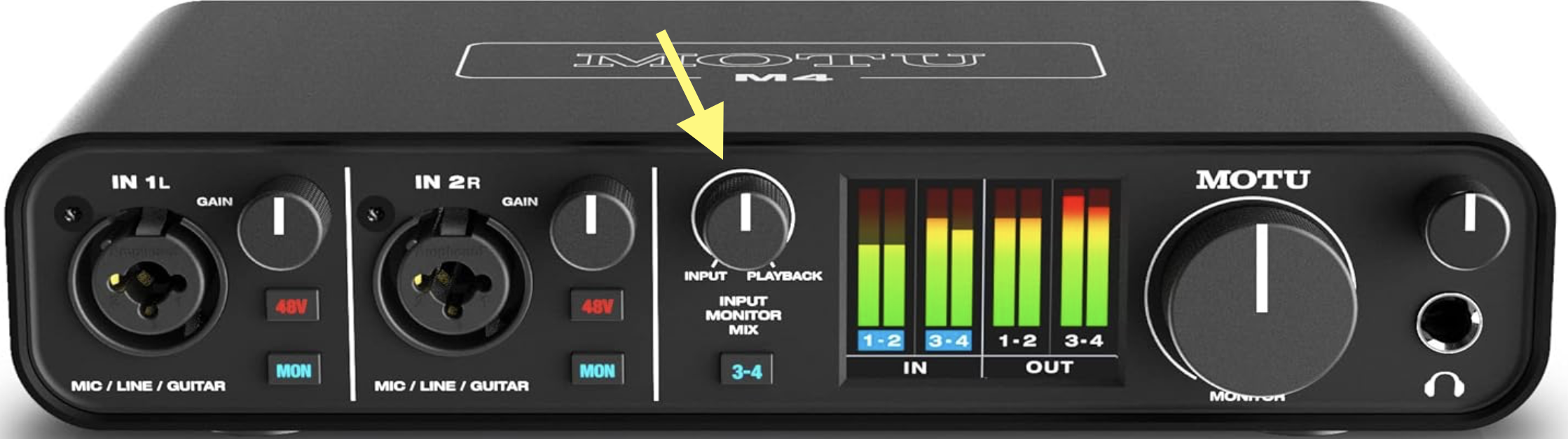

opus11 wrote: Mon Jun 03, 2024 12:51 pm ...I was using the inputs, I just turned them down or up as a troubleshooting. However, I don't have anything connected to the inputs.
The input monitor mix knob adjusts the balance you hear (either from headphones or monitor outs 1 & 2) between any sound coming from the inputs (fully counterclockwise), or hearing any audio sent to the outputs for playback.
I've been harping on this point, because without regard to anything else, if that knob (indicated by the yellow arrow above) is all the way left, you won't hear output.
I asked you what the position of the (single) input/playback knob was, and you said "They are turned down." If you are talking about the knob I indicated, then that is your problem.
You said "I turned them up but nothing different happened."
Again. I don't know what plural knobs you are referring to. The input knobs? (not relevant here), I'm talking about the "INPUT MONITOR MIX" knob. Put it at noon and see if it works correctly.
If you haven't already watched it. This video explains it pretty clearly. It just doesn't mention that "Monitor" is both headphones & outs 1 & 2.

If that doesn't fix it, it might be a hardware problem, like the big knob itself-- or perhaps something where the driver isn't configured right.
I wonder if you could test on a Mac somewhere, somehow-- to at least determine if it is a hardware issue.
