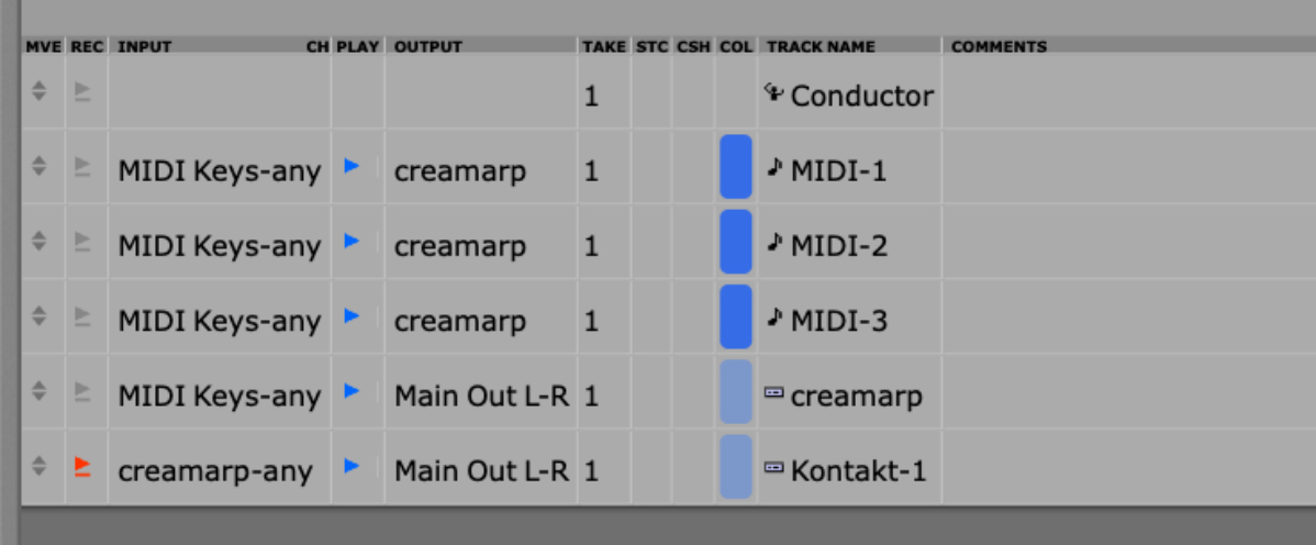

May I ask why using IAC? It should be possible to route through instrument channel (for the arp) and merge all the MIDI to one track for recording, all without using IAC, just using internal MIDI bundles in DP... Not that it really matters that much, because basically the MIDI timestamp still gets reset either way (which is why it was recorded early, ironically). But anyway, Keeping it off an IAC bus is a little cleaner to avoid any accidental sending of MIDI to places you don't want it to go. Just wondering why did you use IAC?
I think using IAC kind of makes sense if you are trying to funnel several MIDI tracks down to one...without using an instrument to go through.

dewdman42
Posts: 1229
Joined: Thu Jul 21, 2005 10:01 pm
Re: route MIDI from several tracks track to another MIDI track
Post by dewdman42 »
See the picture in my last post for arp example
If there is no instrument arp involved then I think you’re right you need some kind of MIDI destination to merge them and iac works for that and I can’t think of another way
