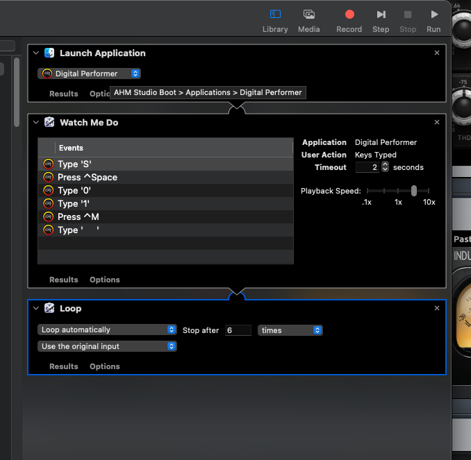

Yes, you can- the app does not necessarily have to be scriptable. I've got some sequences that I usr for auto placement of markers from region boundaries in a track in the Sequence editor that I did by using the Record function in Automator and then massaging the commands as needed. I'd be happy to send that workflow, but here's a screen shot:
- automator markers from regions.png (117.11 KiB) Viewed 4962 times
