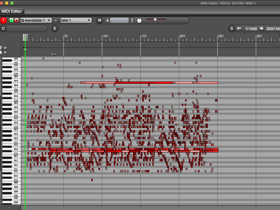

When using the Fishman TriplePlay guitar to MIDI converter, I'm experiencing the random addition of very long notes when recording in DP.
The extra length is the problem.
Somehow, just certain notes are extended.
It happens every time, but with different notes chosen for the random extension.
Makes it a PITA to edit.
The long notes have many layers and in and out points.
I should note that this doesn't happen in Logic or Studio One with the exact same computer and MIDI configuration.
Here's one example, but I could send many more.
Thanks for your help.

Yea, somehow the note-offs aren't getting processed.
At first, I was going to blame some MIDI cable or interface; but you said it works perfectly in other software. Ugh. The only thing I can think of is to make sure your drivers are current.
I'd suggest creating a support ticket with MOTU. If something in their software is missing data from core MIDI, that is a huge problem.

I'd definitely go to MOTU with this one.
Hasn't there, in the past, has been discussion about DP handling of note offs? I don't recall the specific issue, but possibly related.

While waiting for MOTU to fix it, perhaps you could create a “Search” for long notes and save it as preset you can call up.

It's a good point. Here's a quick summary of that other issue.
With two consecutive notes of the same pitch (note #), where the end of note 1 is on the same tick as the start of note 2. DP processes the note-on before note-off, so note 2 sounds (very briefly) then is cut off by note 1's off. It often happens when both attacks and releases are quantized (say, for notation purposes). MOTU has fixed this issue for playback, but not for scrubbing.
I'll be curious to know what MOTU has to say. Please follow up.

That is a great idea!
I went to the Event List and could easily see the very long notes.
Not sure how to do an automated search, but they are obvious.
The problem is that they are notes I played, so I'm not sure how much to shorten them to be accurate to the performance.
I've been in touch with MOTU and will post when we get it figured out.
Thanks for all the help.
