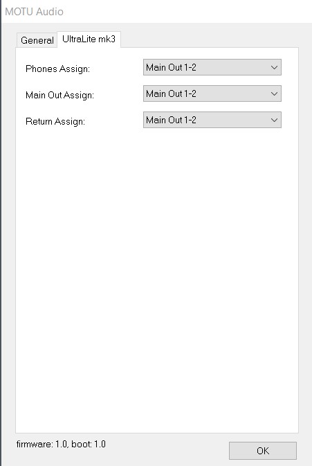

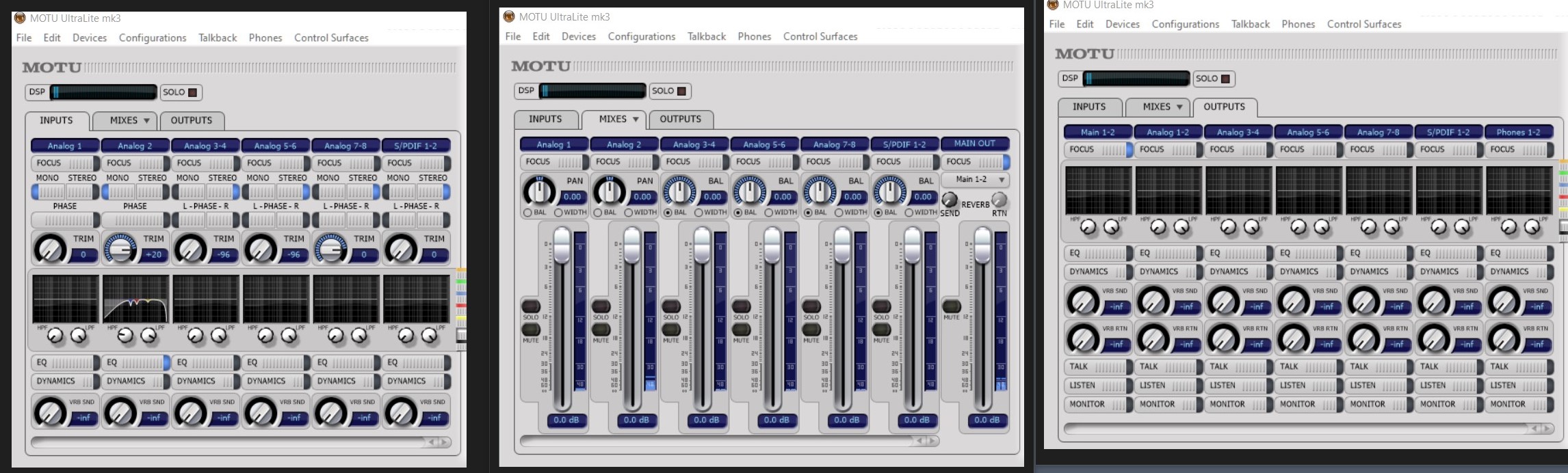

Hello,
I can't figure out how to configure cueMix so I don't hear myself speaking in the microphone when wearing headphones.
I'm using an UltraLite mk3 (firewire-only version, before the hybrid came out), and Windows 10. Last drivers for it are 4.0.6.6814. Attached are screenshots of the various cueMix panels. I also made sure that Windows wasn't listening to the mic.
As a side note, this happens only with the mic plugged into the UltraLite. When I switch to the webcam microphone instead, there's no issue.
Any suggestion is appreciated. Thank you in advance,
