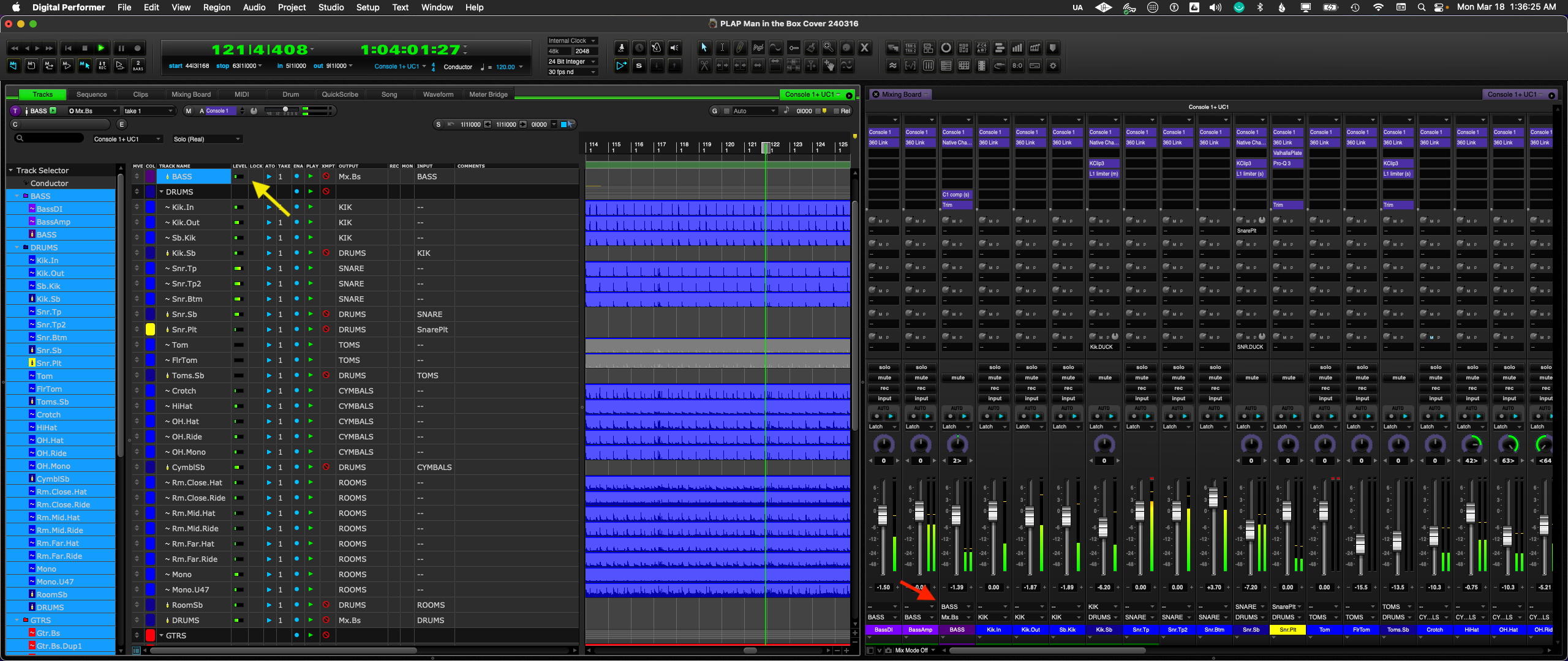

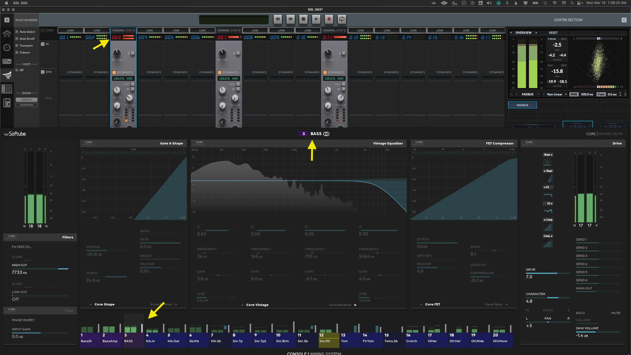

Reference photos attached.
I can see the selected track everywhere, ironically except in the DP mixer, and I can change the selected track anywhere and everything follows along.

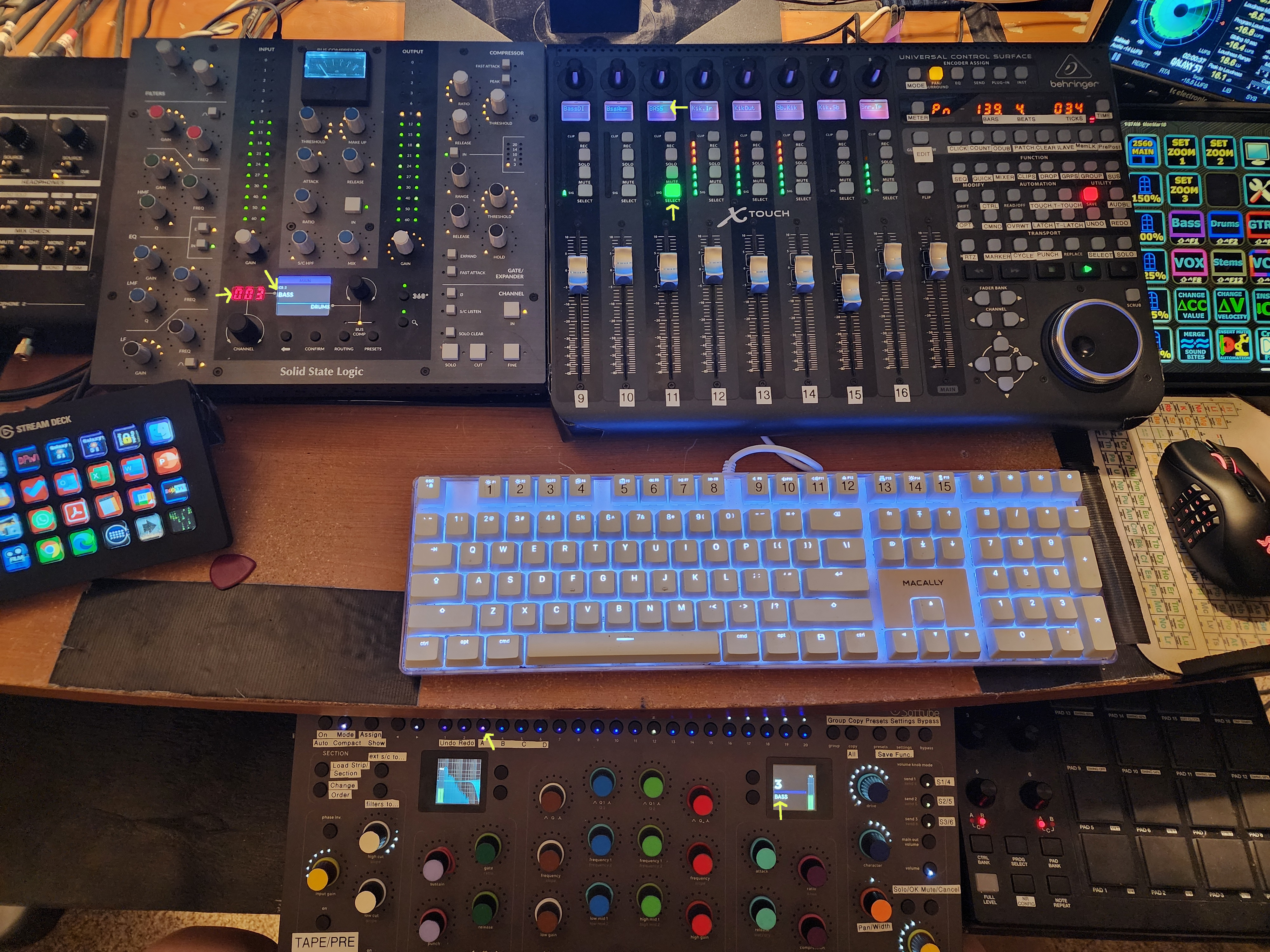

And one more of the hardware
