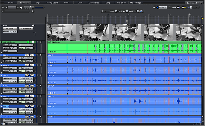

Thanks, all, for the responses.
I think I'm not making myself entirely clear...which might mean that this is not a typical workflow.
I like to mix multi-track recordings in DP while watching the video that corresponds to that audio. So the question is, is there an alternative way to sync the video with that multi-track audio—a way that does not involve using the Set Movie Start Time feature?
Another (similar) scenario: Let's say you're making the next great concert film. You've got a rough cut of the movie, and you want to boost the volume of particular tracks when certain players are on screen—a guitarist walks up to center stage and you want to boost the volume just a little of that guitarist. You'd need to have a multi-track mix open while watching the movie. And of course, they'd need to be perfectly in sync.
You could experiment with the Set Movie Start Time until everything is aligned, but it would be great if there were an easier way.
I'll try to figure out how to show a screen shot...

DP will playback the movie you provide. It will start and stop it anywhere you want. If you want to cut in audio, you need to do that visually, or if your setup is a little more sophisticated, with the timestamp on the audio t match the time on the video. I always do it visually, usually matching waveforms in the sequence window.
You cannot easily slide the movie around in DP as you can in a video editor, which is why in my earlier post i suggested having a locked video. If that isn't possible, then I'm not sure how to help.

OK, so how do you visually match the waveforms in the sequence window? That's exactly what I want to do, but I'm hoping to move the video audio (and the video with it) rather than the multi-track audio.
I think I'll also have to learn what it means to have locked video. I thought you meant that the audio captured with the camera should be locked to the video captured with the camera—I agree, and I'd never unlock that. But if there's a way to lock the multi-track audio to the camera video, that would be even better, and I could avoid this sync'ing later. I just haven't learned how to do that yet.

You're trying to sync the video to the audio? You cannot do that in DP. You can, awkwardly, in video editing apps.schmargle wrote:... I'm hoping to move the video audio (and the video with it)...
You seem to be reluctant to move the multi-track. Why? What's the big deal in moving that?
BTW, locked video (usually referred to as locked picture) means the visuals will not change and other post operations (usually sound) can depend on the timing not being altered. Of course, in the real world, that's a fallacy. Directors and producers are fickle creatures and don't always like to play by the rules.
Speaking of playing by the rules. You either have to stop thinking of the multi track recording as unmovable, or prepare yourself for a world of pain.

Yeah, that's what I'm trying to avoid. If I move the multi-track audio, then it will no longer be aligned to the grid and click, which can make comping, editing, and mixing the audio more difficult.HCMarkus wrote:Move the multi-track audio in DP, align with the video and its audio.
Maybe what I want to do is just not possible (yet) in DP.
Re: Best way to align/sync video to recorded audio
Ha! Yeah, exactly.MIDI Life Crisis wrote:You either have to stop thinking of the multi track recording as unmovable, or prepare yourself for a world of pain.
I've only mixed sound for one film—it was in DP, and the experience was VERY painful for similar reasons. The director kept making edits and asking me then to revise my mix. In that case, I was willing to move the multi-track audio, but I still had to visually align waveforms with the new video I'd receive. I kept thinking: "This can't be how professionals actually do this."
So maybe I have to try to Google more about how professional sound editors do all this. ...Or just use Logic, which does allow you to shift the movie more easily on the timeline, though you're still constrained to moving by frames (or some kind of subframes) rather than samples.

Just break up the multi track into manageable bits and edit the damn thing, already! Bounce the sections you want to add or just copy and paste them into the proper place. You should be able to patch up the waveforms easily. Again, import the video audio so you can see it. Open it in the sequence window, paste or import the segment in question, and do you crossfades, edits, etc.
I'm just not understanding why you can't do that. Is the time line on the multi track different (longer?) that the video? Why doesn't it just sit in one with it now? there's a piece of your puzzle that is missing.

Sorry, missed that point in your initial post.schmargle wrote:Yeah, that's what I'm trying to avoid. If I move the multi-track audio, then it will no longer be aligned to the grid and click, which can make comping, editing, and mixing the audio more difficult.HCMarkus wrote:Move the multi-track audio in DP, align with the video and its audio.
Howabout this: Drag music to the nearest beat, use conductor track for tempo/meter, set correct tempo/meter at downbeat, then play with tempo/meter before the music starts until you line it up. Kludgey, but doable.
