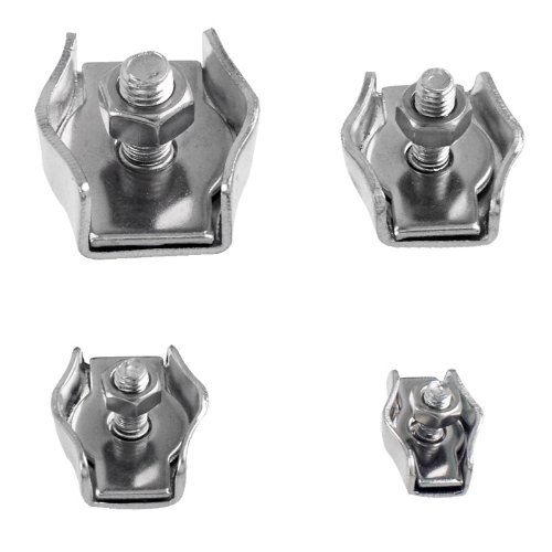

All you need are two cables to prevent twisting and some cable clamps available at any hardware store. Picture wire can be purchased that's rated to 100lb or more - you want it thick enough so that the clamp will secure it.. Attach the cables to any of the bars below and hang your array from the middle.
Cable clamps - these are too big but you get the idea
These are fine, too
Do not use these in a commercial setting (around people). They can fail.
These are fine, too
