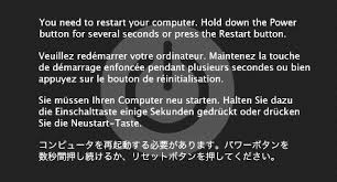

I ignored it, and I was cloning an HD with CCC, and then the computer froze with a frightening message I had never seen. I took a picture of it with my iPhone, but won't be able to upload it until later.

Was it the Kernel panic?
Yeah, you have a RAM problem for sure. Rember is the way to go. You may be able to salvage the situation by merely re-seating the RAM after cleaning the contacts. Good luck.

That's EXACTLY what I got! The text was a little different, but it looked like that.
