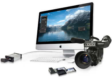

Well, if a late model iMac is at issue, then the firewire buss will be less of a concern. Where the previous standard was 33Mhz, today's firewire busses are blazing along at 2.6 GIGAhertz!! An fw interface and a pair of fw drives should be no problem.
Still, I would consider splitting out the heavy-hitting VIs into separate drives. All that said, there are always limits. The benefit of the towers was in their expandability where a diversity of data busses were made possible. That wasn't always the case with the iMac.
I would consider Thunderbolt sooner than later. Where SATA/eSATA offers 3GB per second of data transfer, Thunderbolt offers 10GB per second. You would need to get a Thunderbolt box plus a firewire adapter that snaps into the Thunderbolt box.
Check out the pic. On the left side, you'll see the little T-bolt box with the fw card poised in front of it.

TBolt will handle your drives, just a tad costly at present.
Re: Firewire 2 External drives 828MK2 one FW 800
Not sure what "costly" is these days where Thunderbolt goes, but a Sonnet Echo 34 TB hub-box is running abut $130. The express card for fw is coming in around $100. I paid gobs more for my PCIe/PCIx cards to the same (but slower) effect.HCMarkus wrote:TBolt will handle your drives, just a tad costly at present.
For $250 or less, that's an awful lot of oochie.

Don't forget the $50 cables... but yes, a lot of power is now available to iMac, Mini, and laptop owners.Frodo wrote:Not sure what "costly" is these days where Thunderbolt goes, but a Sonnet Echo 34 TB hub-box is running abut $130. The express card for fw is coming in around $100. I paid gobs more for my PCIe/PCIx cards to the same (but slower) effect.HCMarkus wrote:TBolt will handle your drives, just a tad costly at present.
Yeah. Oochie has its price, doesn't it?HCMarkus wrote: Don't forget the $50 cables... but yes, a lot of power is now available to iMac, Mini, and laptop owners.
But, I think that with the hub and the card, the rest will be about just using FW cables.
