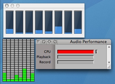

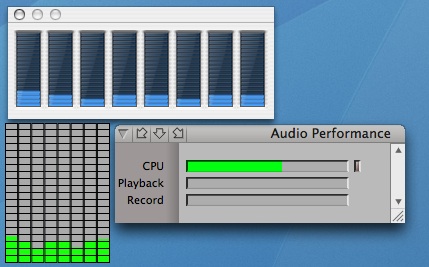

This template on the G5 used to take 50% sitting idle. When I would hit play with a moderate sequence, the processor would jump to 80+%...especially when the choir in MachFive would get going. Frequently, the G5 would suffer at 100% with red spikes.

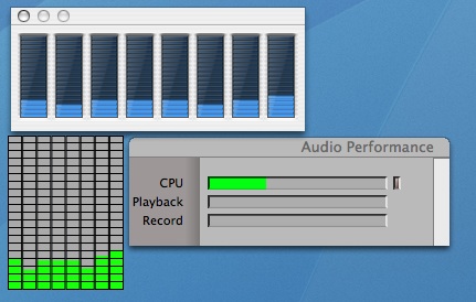

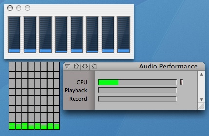

On the Intel, the same setup takes 25% while sitting idle. Initially, I was kinda bummed that it wasn't lower, but once I finally got everything setup (transferring patches from MachFive into K2) I was pleasantly surprised when I actually started pounding on it. When I hit play and have lots of stuff playing---choir in K2, perc hits in K2, Orch stuff in K2, several RMX parts, many many MIDI notes triggering on pcs and coming in the Auxes, etc---the DP Processor bar never goes above 33%....! This is VERY cool in my book. I am very pleased with this performance. This sequence would easily have had the G5 100% slammed and peaking. So, I'd say there's quite a bit of real and usable horsepower under the hood.
Here's a pic with the template fully loaded and sitting idle:
Here's a pic while it's playing lots of stuff:
