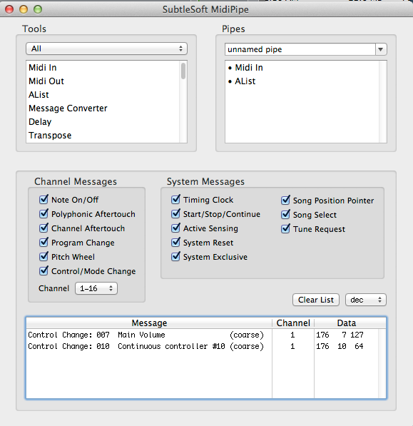

Yeah, Babz- the way you've configured your pipe, it's seeing INPUT 4 on your MTP, which is the Alesis' output.

would there be a way to loop the MIDI data back from one track and record it to another for viewing? As long as Patch Thru is off it should be possible.
You could use a cable on your MTP or maybe use virtual MIDI ports

Thanks! That was the part I was missing! Didn't realize I could assign MidiPipe as an input in DP.SMS wrote:
in DP:
• route a MIDI track to "MidiPipe Input 1"
So this is what I get (regardless of automation enabled or disabled). Basically Volume and Panning. Somehow this is messing w/ the Alesis. How do I get DP to not send out Volume and Pan to this track? Or how do I get the Alesis to ignore Volume and Pan CC?
Babz

Yeah. That's exactly what I saw.

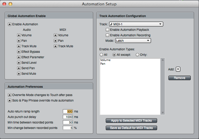

Yes, it's only an issue w/ the Alesis's internal sounds (i.e., all is fine w/ VIs and other hardware synths). Ironically, I probably won't even use the internal Alesis sounds very often, but these kind of odd MIDI mysteries drive me crazy and I just can't stand not knowing what's going on.SMS wrote:I'm guessing you're using the internal sounds, so don't want to block all controllers...
Studying the DP manual, I think I have finally come up with a viable solution. The Automation Setup window (Setup->Automation Setup) provides extensive options for enabling and disabling automation, both globally and on individual tracks. I was able to turn off Volume and Pan automation for just the Alesis MIDI track like this (which solves the problem):SMS wrote:Odd there's not a direct way to selectively block controllers, even in MidiPipe.
It may be that it just "sounds" similar to local on note doubling. Something definitely gets louder and the panning sounds all weird. Mostly I've been testing with the same preset on the Alesis "TrueStereo", a piano sound. Whatever is happening makes it sound awful, but I may have mistaken it for note doubling. I'm still searching for a way to disable reception of Volume and Pan on the Alesis, so I don't have to do it within DP.SMS wrote: Got to be a bug in the Alesis. Can't think of any reason those controllers should turn local on.
Thanks so much everyone for your help and support on this. This is a truly strange one, and I'm not sure I fully understand what is going on, but I've made a lot of progress.

Re: Baffled, Bothered, and Bewildered by MIDI Issue -- Help!
Update:
Upon further testing, it appears it is only the Pan (cc10) controller that is causing the problem.
What appears to be happening is that hitting Play in DP causes it to send out cc10 information that is somehow altering the sound of the Alesis. It makes it sound kind of like note doubling. It sounds almost as if it is taking the Alesis stereo signal and doubling it to both channels.
I have to wonder if this is a bug. Could it be that DP is somehow sending out some sort of "corrupt" cc10 data?
Babz
