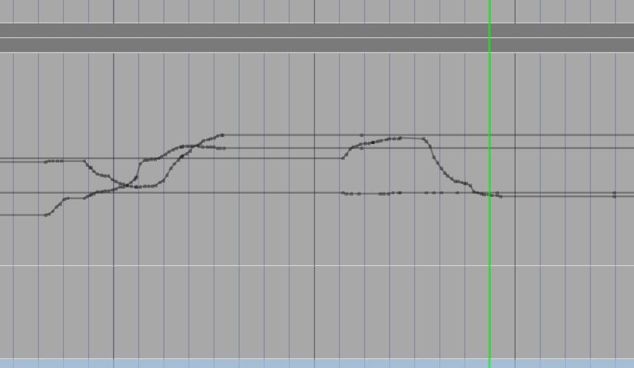

Fab Filter EQ3 responds great to some random moves... Click anywhere on the timeline and FFEQ3 immediately jumps to the appropriate settings at that point in time. Here's the recorded data:
