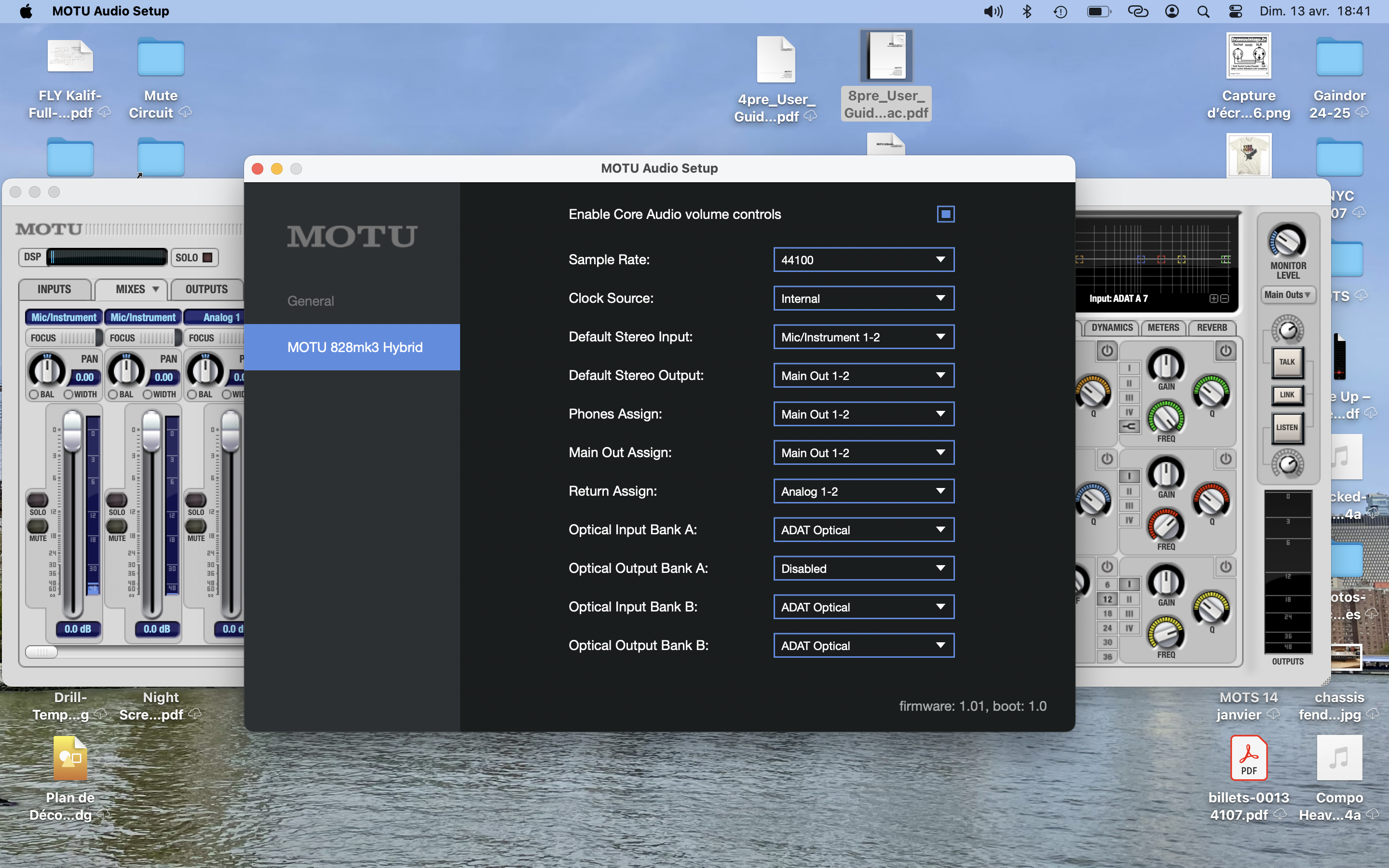

Hi
I recently acquired an 828 mk III hybrid and an 8pre Firewire. I'm using an M1 MacBook Air (OS 14.7.4). I installed the latest MOTU installer (Mac v89555) following the procedure described (https://motu.com/techsupport/technotes/ ... audio-inst).
The card is recognized on my computer. I can use the two XLR inputs, as well as the eight line inputs. The outputs are also available.
CueMix FX and MOTU Audio Setup are available and working.

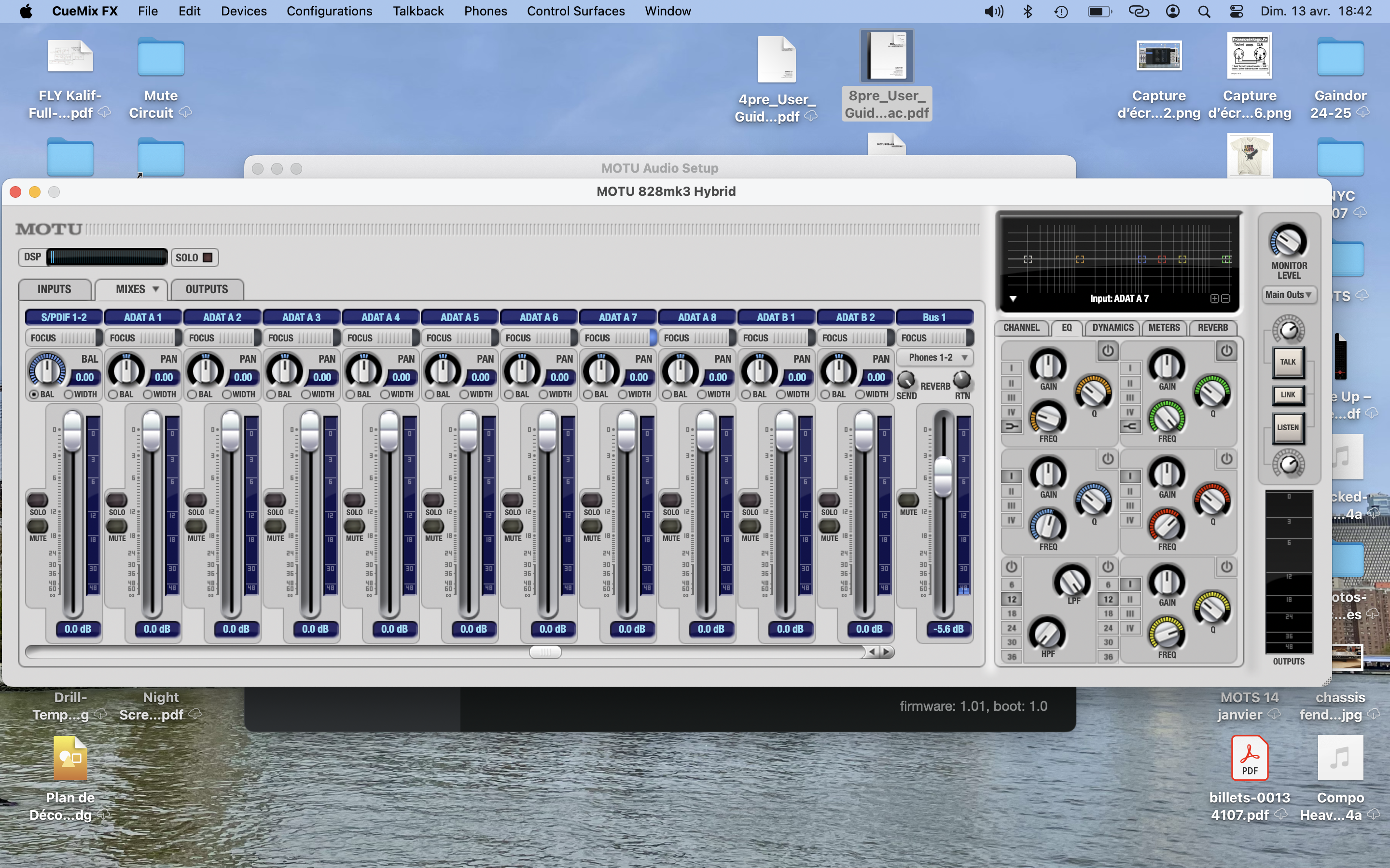

However, I can't use the card's ADAT. I tried connecting the 8pre Firewire; the preamps work, but the signal doesn't appear on my computer. In CueMix FX, Bank A and Bank B appear (I selected them as "ADAT optical" in MOTU Audio Setup), but no signal appears.
I tried with another ADAT preamp (Audient ASP800) and the problem is the same. This preamp works in ADAT with a different sound card.
I should point out that I tested with different optical cables.
I've read several threads on this forum related to my problem, but nothing works :banghead:
Can someone help me please?
Best :headbang:

Posts: 16246
Re: 828 MKIII Hybrid and ADAT Issue
MOTU's overview states that what you want can be done on a Mac. It should just work.
https://motu.com/products/motuaudio/8pre
These are the two most likely things:
Are you letting your DAW access the Mac's microphone? This must be done for all audio and AV apps on a Mac.
Settings/Privacy & Security/Microphone
Have you reset everything to factory default?
https://motu.com/techsupport/technotes/reset
Although your 8pre is no longer supported, the 828mk3 Hybrid still is (I think). If the above suggestions don't work, I'd contact MOTU Support.
