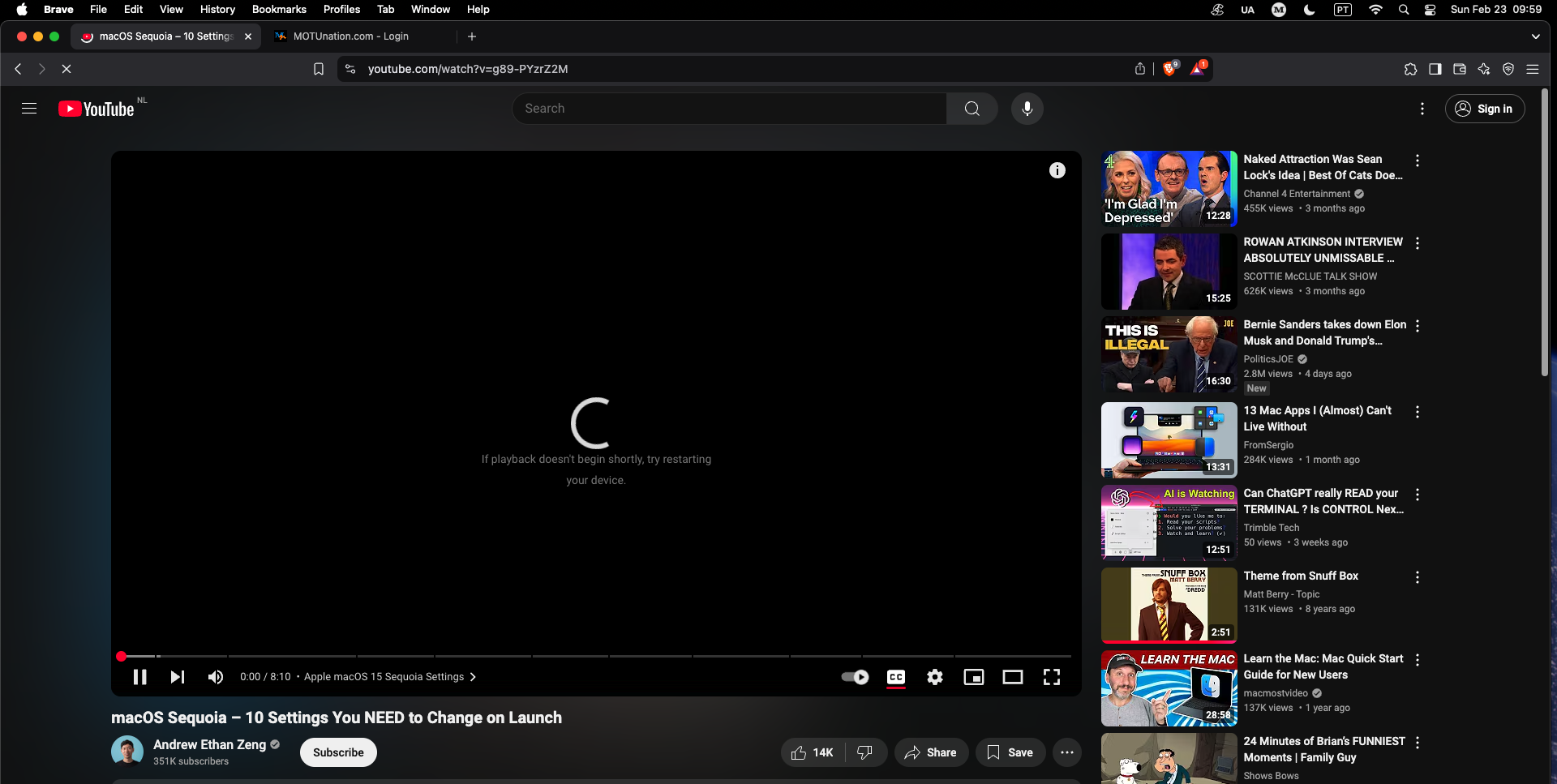

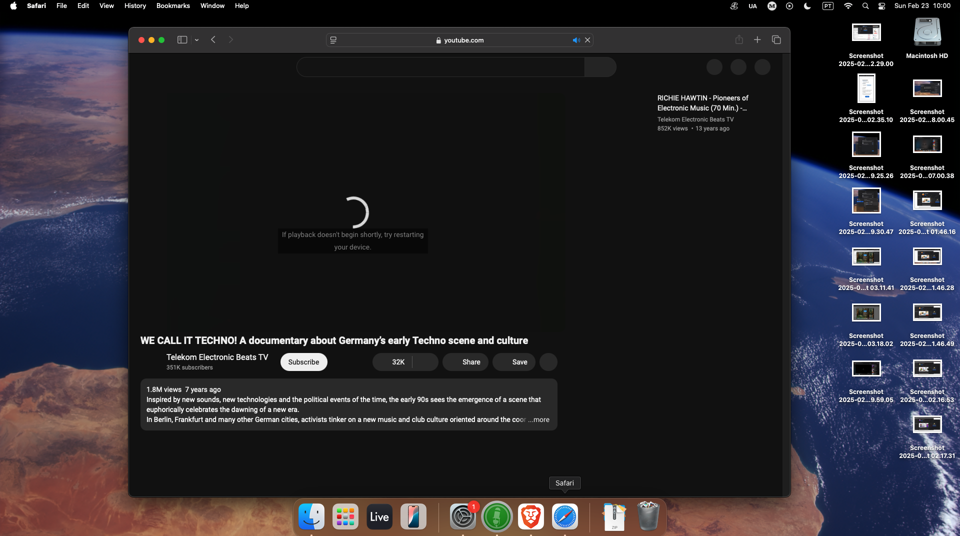

I have the same issue with my Motu 828 MKII U.SB, but I use a Mac Mini M4, Sequoia 15.3.1 (24D70), Ableton 11 suite and 12.
I´ve tried your suggestion and bought a USB-B to USB-C printer cable to connect it, but unfortunately, it didn't work.
I tried before with a normal USB-B to USB, but I had no luck.
I´ve tried to install the latest Gen5 drivers, the one you suggested, the 828x, 1296, but also it didn't work.
The sound card is being recognized, but it can't play any sound.

Maybe you guys can help me out.
Using YouTube, for example, the video won't even start.
Thanks!

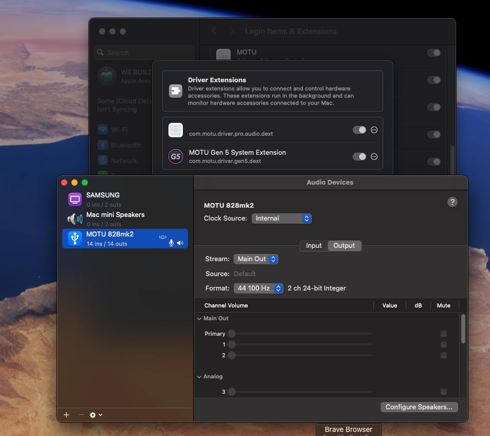

Hi Mike and Mothra!mikehalloran wrote: ↑Sun Feb 23, 2025 2:02 pmCorrect. That will not work. This is the correct driver from the 828mk3 Hybrid site:The 'Gen 5' drivers don't support the 828 lineup at all.
I do not recommend this, however, due to potential wake from sleep issues:MOTU Audio Installer
Mac v89555 | Oct. 13, 2021
macOS 14, macOS 13, macOS 12, macOS 11
USB 4 hubs work fine, however including this one:Connected via a USB 3.1 hub.
https://www.amazon.com/dp/B08NWL5V86?re ... title&th=1
I have my USB 2 devices now going into the USB-C ports including my iLok and USB 2 interfaces (through adapters or USB Printer cables). I have not experienced a wake from sleep problem since adding it last December.
I´ve uninstalled all the Motu drivers I had installed previously and installed the Mac v89555 | on Oct. 13, 2021.
I also restarted in "safe mode" and gave permission to install software from the Apple Store and known developers.
I guess my issue is coming from the USB hub. I have it connected using a cheap USB hub
I will order the same one you have, @mikehalloran, and hopefully, it will solve my problem.
I will let you guys know when I receive my new USB hub.
Thanks again for your help.
