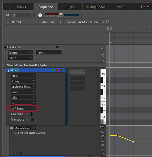

On the MIDI page I can select whether I want to display/edit continuous controllers as Points, Bars, or Lines.
Is there a way to select the continuous controller display/edit mode (Points/Bars/Lines) on the SEQUENCE page?
Thanks!
wwzeitler
Posts: 62
Joined: Thu Nov 21, 2024 3:37 pm
Re: Editing Continuous Controllers on the MIDI page vs. Sequence
Post by wwzeitler »
Why, yes there is! I just wasn't making the Sequence page lanes tall enough to see the "Points/Bars/Lines" dropdown.
