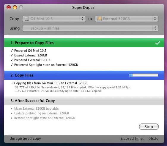

Cool... well nothing ventured, nothing gained. It will be interesting to see if the G4 works. I downloaded the correct version of Super Duper of their site... free version... and am in the middle of doing the copy. It's going to take a while. It is encouraging that it didn't give me the warning that it would not be bootable and in fact it implies from the screen shot that it's going to make it bootable. We shall see. Big thing is that maybe it just doesn't take into account the USB limitation?
I'll report back what happens. Be really nice if it could boot from this drive.

Actually don't think Super Duper worked. When it was all finished Startup Disk doesn't show it available as one of the choices.
My most economical option maybe be to contact the seller as he had two for sale and when I bought the first he offered to throw the second one in for $20. I ought to just set up a redundant box and then set it away for safe keeping. Ugh.

Nope. PPCs can boot from Firewire, SCSI and networked externals, not USB. With Intel Macs that changed to USB (FW wasn't supposed to work but sometimes did), Network and eSATA.
CCC and SD! are APIs for Disk Utility (and now Time Machine). Neither app can do anything unsupported by Apple.
Back in my school district support days, I would make a Master Drive and clone hundreds of G3s and G4s so that every student's desktop was the same when school opened. CCC was a little faster than doing it in Terminal. The reason for not doing it over the network was so I could run Disk Utility and replace questionable HDDs first.
