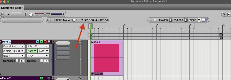

I'm only seeing options for viewing soundbite duration in terms of either samples or bars and beats. How do I go about getting soundbites' duration to display in the top of the Sequence Editor? I feel like DP used to do this but I cannot find it now!

Easiest to show you.Irimi Nage wrote: ↑Sun Dec 29, 2024 4:06 pm I'm only seeing options for viewing soundbite duration in terms of either samples or bars and beats. How do I go about getting soundbites' duration to display in the top of the Sequence Editor? I feel like DP used to do this but I cannot find it now!

In the Sequence Editor, if you select the soundbite, you'll see the duration at the top of the screen, it appears to be shown in beats & ticks. [EDIT: I thought I was seeing a weird duration value, but it was just user error]

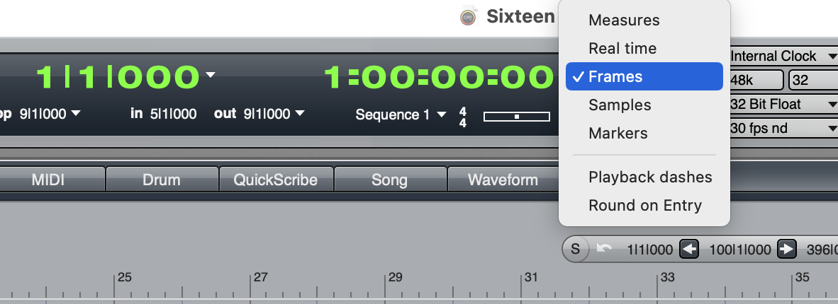

Re: How to view soundbite duration?
Check in Time Formats (ctrl-option-T and show details) to select how you want to view in different lists/windows.Irimi Nage wrote: ↑Mon Dec 30, 2024 5:50 am It’s a valid tip but it’s less clicks to open the soundbite in the Soundbites window. Still I could swear we’ve had the ability to do this for years in the event info displays…?
Sorry, on Mac cmd-option-T. Switching back and forth gets confusing occasionally. Ctrl-alt-T on PC.

This delivered the thing I was asking about, thanks so much!CharlzS wrote: ↑Mon Dec 30, 2024 12:07 pmCheck in Time Formats (ctrl-option-T and show details) to select how you want to view in different lists/windows.Irimi Nage wrote: ↑Mon Dec 30, 2024 5:50 am It’s a valid tip but it’s less clicks to open the soundbite in the Soundbites window. Still I could swear we’ve had the ability to do this for years in the event info displays…?
The right click - Soundfile Info suggestion was really good too.
