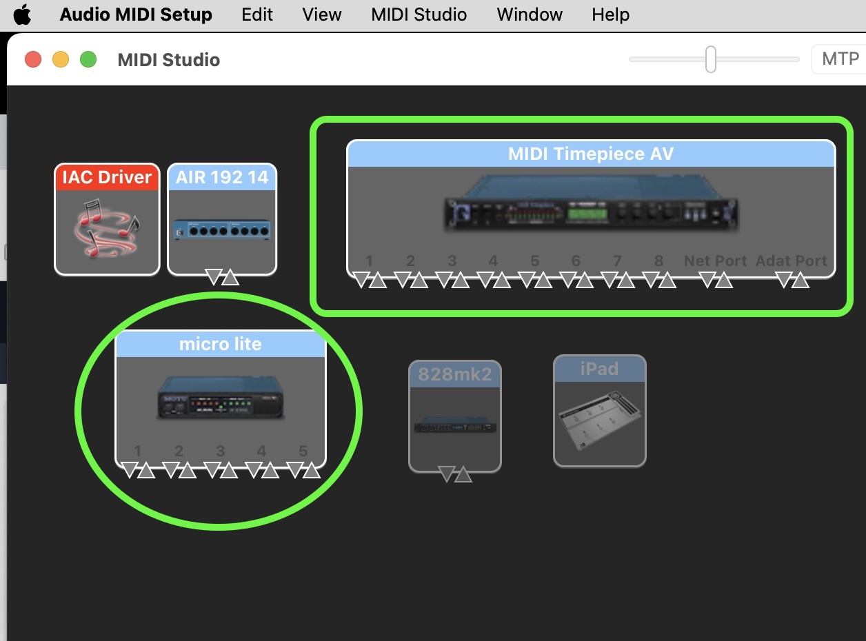

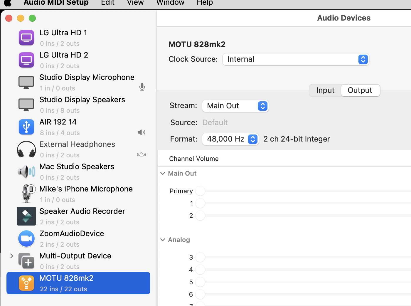

...without MOTU doing a screenshare to see the conflict, that wasn't going to happen. They will do this only on interfaces that are still supported. In my case, the offending .kxt was found when they helped me through the MIDI install on my supported micro lite — afterward, the Audio driver install on my unsupported unit went smoothly.
Anyway I don’t think I will make any updates anytime soon.
I will go Sequoia a year from now, when a new version is being launched to minimize the updates I will have to deal with.
I have my 828mkII FW and my MTP AV & micro lite units running just fine over Sequoia. Since both were fresh installs, zero problems (as long as the MIDI driver is installed first).
