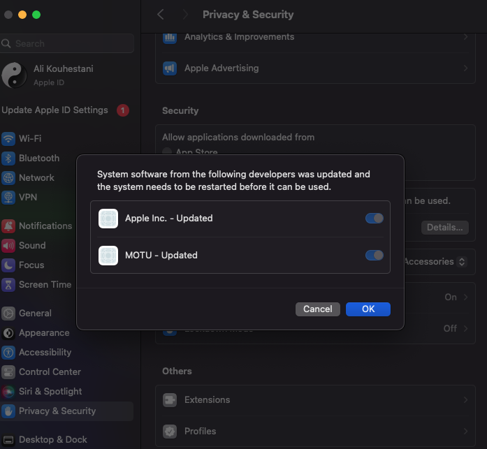

Hi guys,
My mac doesn' t recognise my soundcard (Ultralite MK3 Hybrid)
Last Night After updating my macbook air M2 to latest sonoma version (14.6.1), I get "System Extension error" at startup, after going to privacy and security setting it says: "some system software requires your attention"
after clicking "Details", It says: "system software from the following developers was updated and the system needs to be restarted before it can be used."
Listed names are "Apple Inc-Updated / Motu-Updated", then I Click on OK and after putting my password and choosing to restart, System Restarts.
after loading , I Recieve the exact "System Extension error" Again, Like Nothing has changed! Everything is just like before and again it needs to restart. I did it again and again and no change at all.
before this update my OS was a lower version (14.0) of Sonoma And everything was working fine.
fixes and workarounds I've already tried:
1. from Startup Options I Select “Reduced Security” and enable “Allow user management of kernel extensions from identified developers” to allow installation of software that uses legacy kernel extensions.
2.uninstall and remove all drivers and installed it again with the latest version that is availabe in website, the one was installed before and was working fine.
3. Repair startup disk with First Aid
4. disconnect second monitor and disable any mouse or touchpad assistant to adjust privacy settings.
5. do all the thing that mentioned above with and without connecting soundcard.
6. remove motu .kext files from library, restart, to Solve "apple Inc-Update", then after restart the error was gone, after that install motu driver, restart, recieve Error and "Apple Inc-Updated / Motu-Updated" is there again.
Any suggestion?
thanks

- Screenshot 2024-09-08 at 8.31.03 PM.png (143.8 KiB) Viewed 2947 times

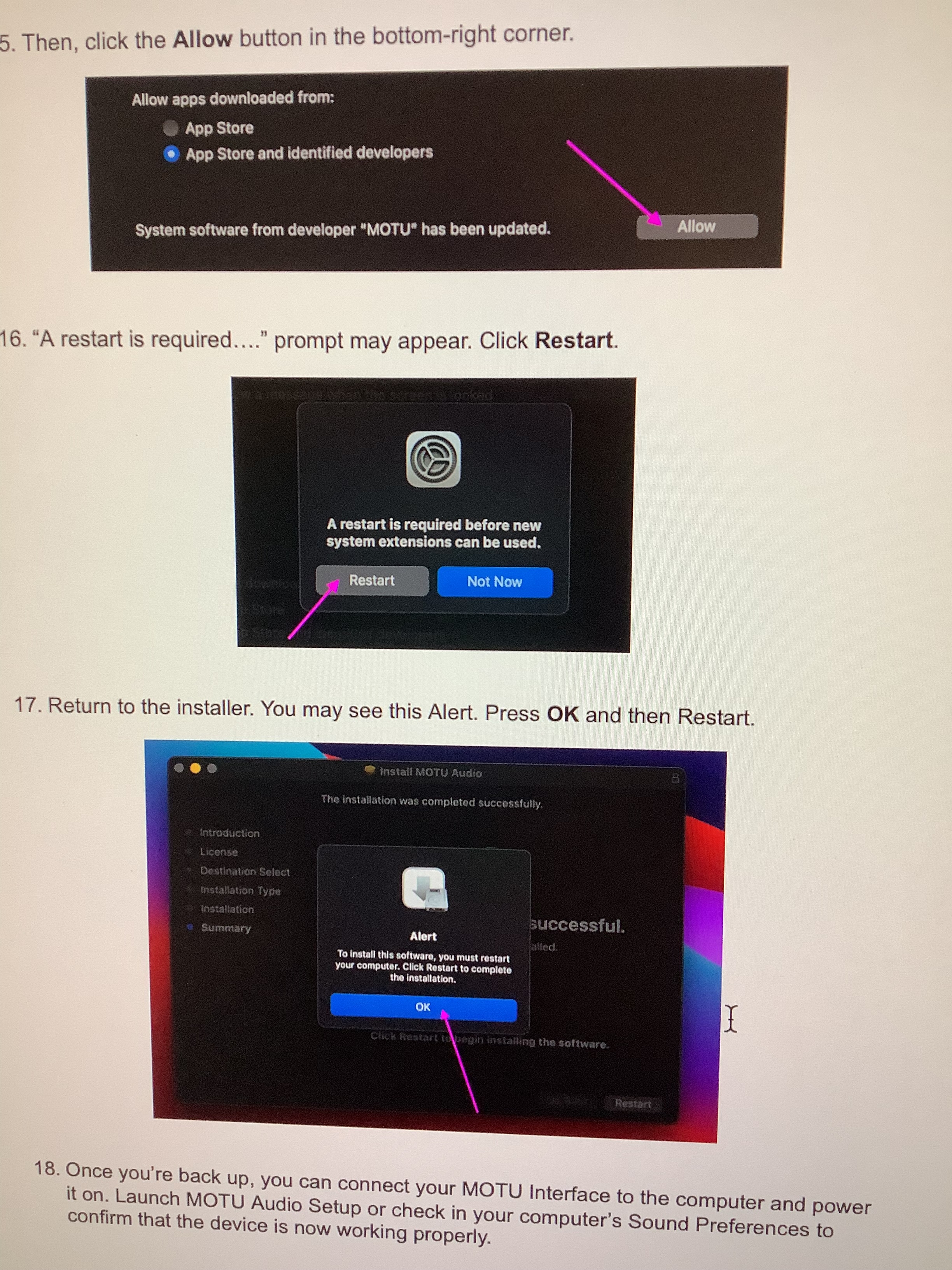

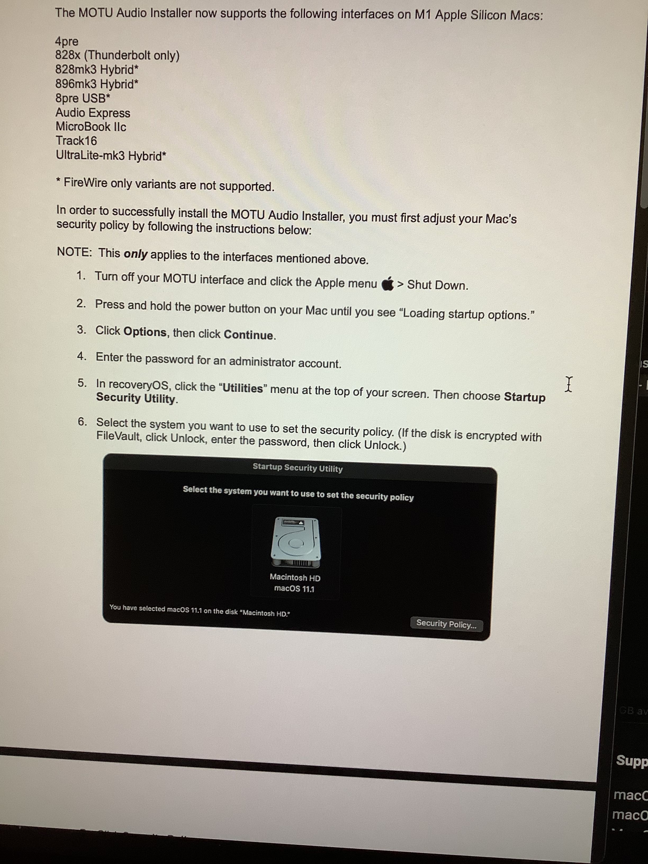

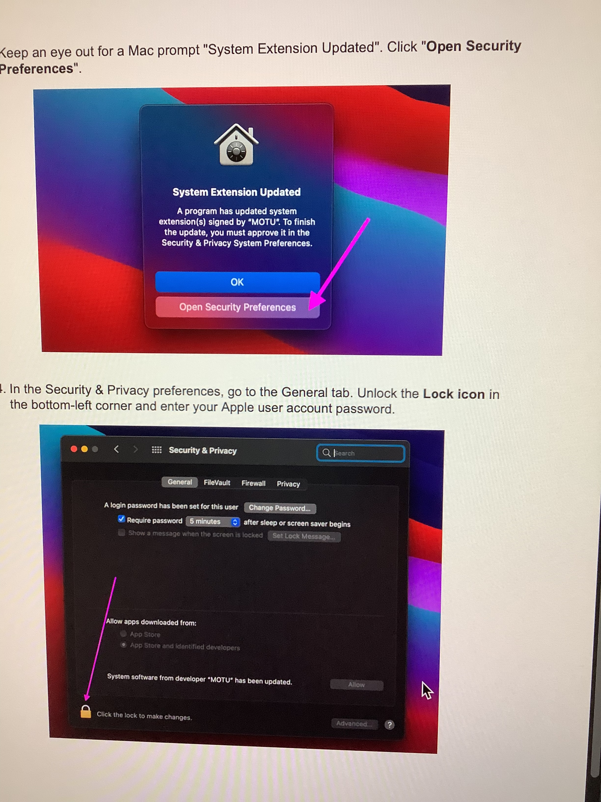

I'm on an M1 Studio and 828x running fine. For anyone having trouble, these are the exact steps I used to install the drivers:
- IMG_0036.jpg (2.45 MiB) Viewed 2816 times
- IMG_0039.jpg (2.54 MiB) Viewed 2816 times
- IMG_0038.jpg (2.53 MiB) Viewed 2816 times

Hey Mario,
did you erase the disk via startup options? somebody told me you have to erase it in another mac and install a lower version of OsX than sonoma and after that, put it back in the first computer. That sounded a bit weird to me. Except, the installation is somehow hooked to the hardware itself.
Also, were you installing 14.6.1 again or did you use another version?
Thank you for info,
steve
Thank you for info,
steve
