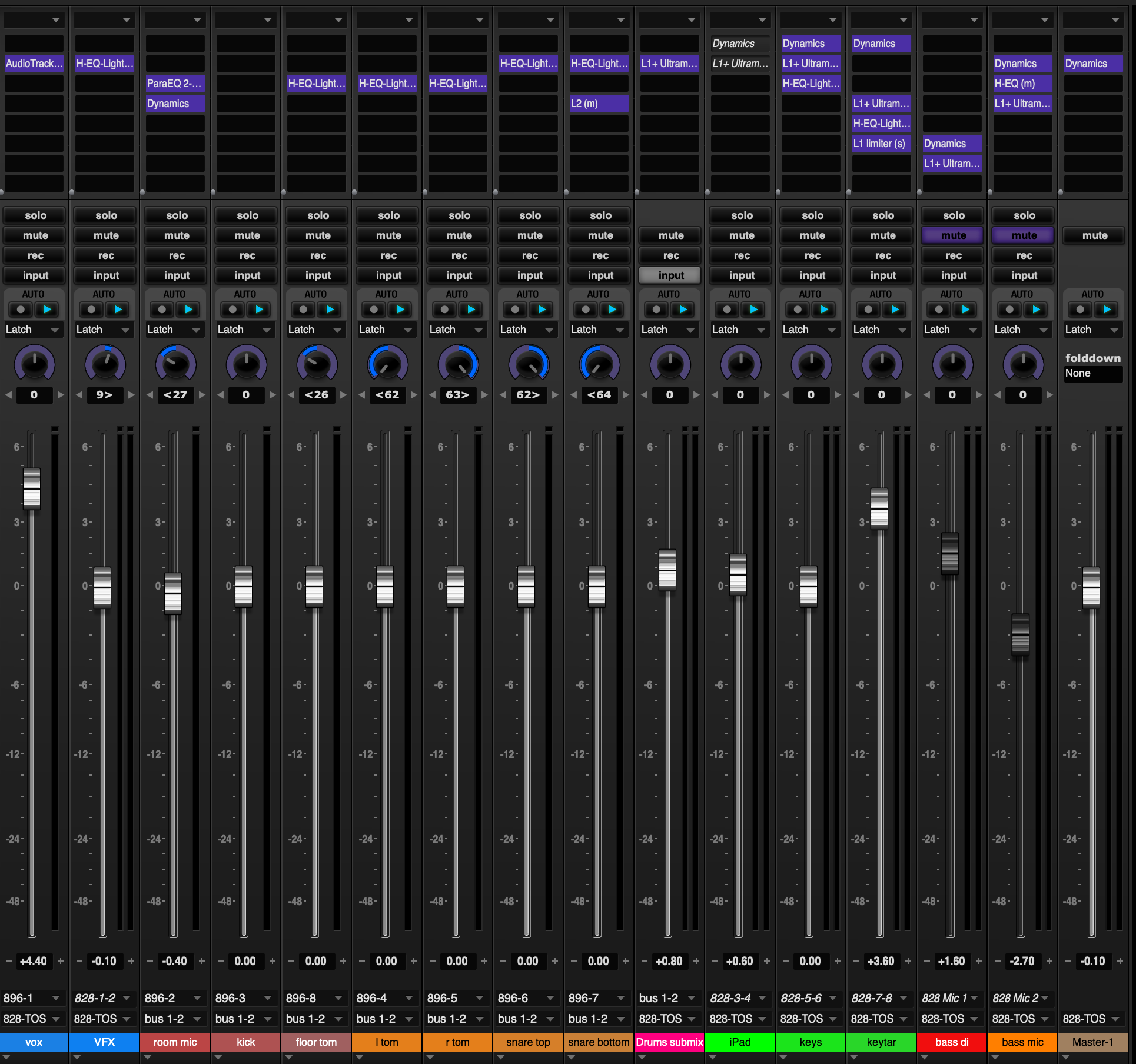

Settings that have been working fine:
- Live Performance Mode enabled
- at 44.1 khz, 24-bit, and a 128-sample buffer, we can run 2 to 4 plugins per channel on the following mixing board without peaking the realtime meter (using plugs like Waves L1+ Ultra Maximizer, L2, L1 Limiter, MOTU Masterwork EQ, Masterwork Limiter, Dynamics, SubBass, Dynamic EQ, and on the final mix: Waves Abbey Road TG Mastering Live, with typically 2-3 plugins per channel):
Screenshot 2024-07-11 at 1.26.21 PM.png (527.94 KiB) Viewed 2504 times

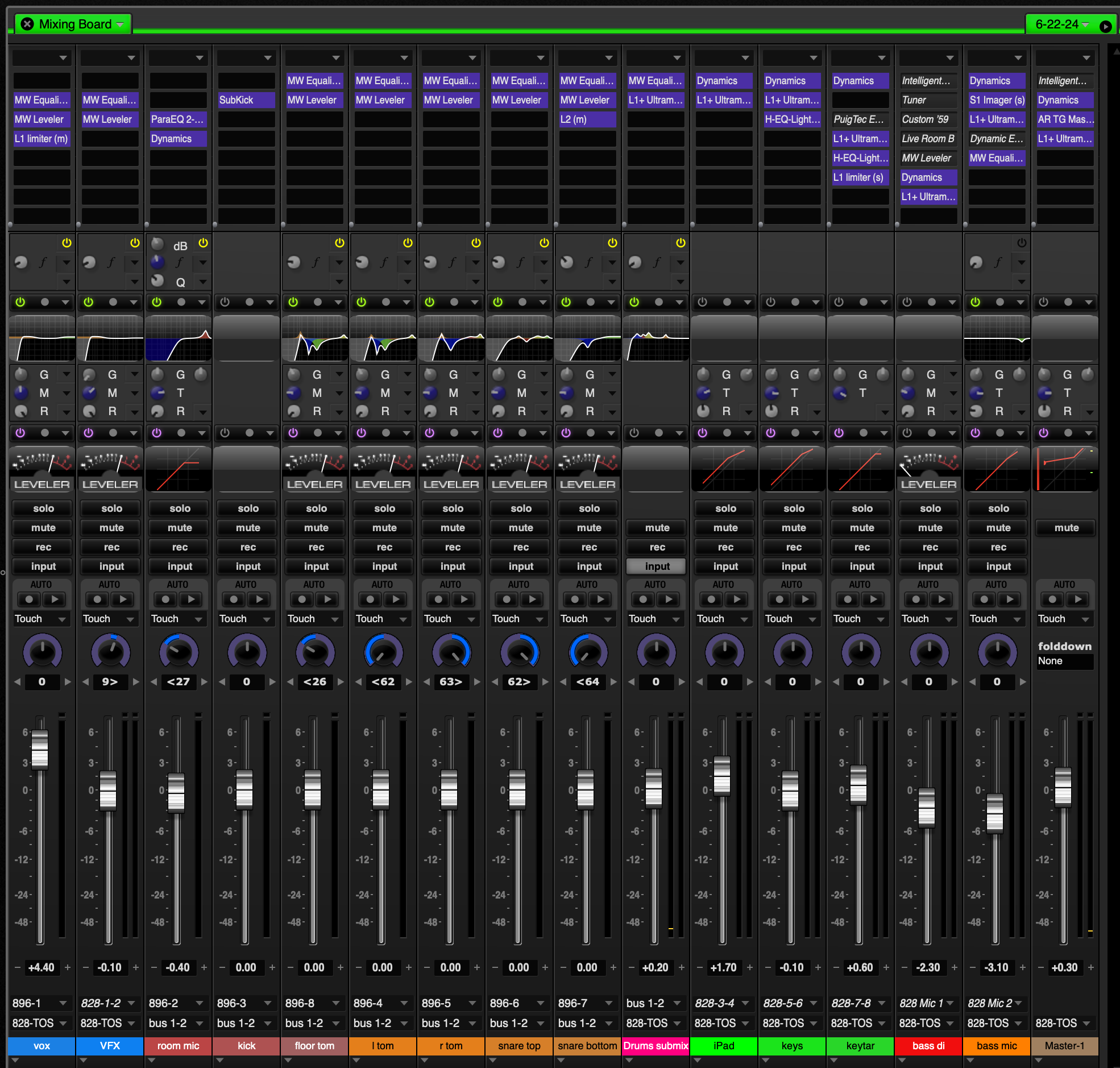

Problem settings:
- at 96 khz, 24-bit, and a 256-sample buffer, even after switching out the CPU-expensive MOTU Masterwork EQ plugins and replacing them with Waves H-EQ Light, I still had to remove all the Masterwork Limiters, SubBass, Abbey Road TG Mastering Live, and several others, in order not to peak the CPU and cause audio pops in the live Main Mix output (and even then, it's still very borderline with the occasional pop):
Screenshot 2024-07-11 at 1.01.15 PM.png (376.6 KiB) Viewed 2504 times
Obviously, 96 khz is more than 2x the data of 44.1 khz, but in Activity Monitor, my CPU is barely taxed at all. In total it's less than 10% used. So I'm very confused why there is not enough CPU in this machine to handle the original project considering I doubled the sample buffer to 256. It feels like DP11 is simply not using all the available CPU cores.
Does anyone know if there is any settings I could disable or enable, or particular plugins that I should be using or not using, to be able to do what we are trying to do here?
I'm also asking, because I've been wanting to replace my audio interfaces with something more modern, considering the drivers aren't officially supported anymore. I've been looking at a bunch of different options, and just trying to gauge how important I should be considering DSP plugins. I was hoping the M-series chips were getting powerful enough to avoid having to worry about DSP crap anymore. I've also been looking into those new plugins that run on the GPU but haven't tried them yet.
Thanks for any advice.
