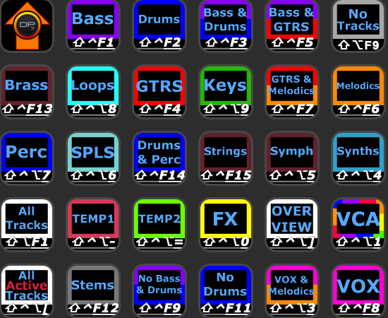

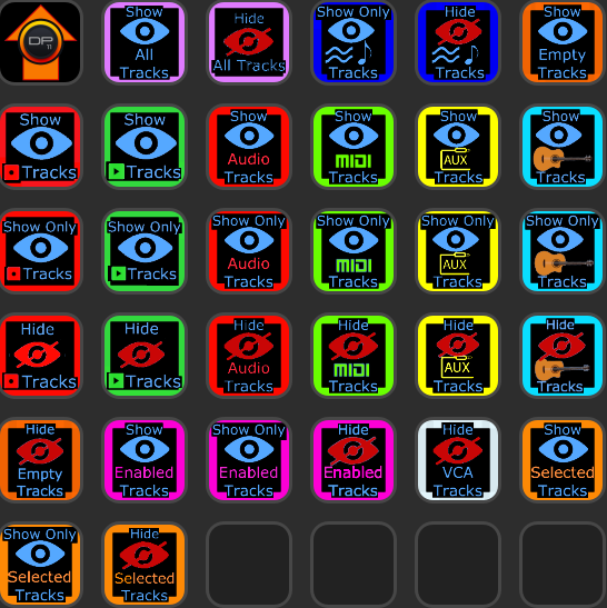

That's a good one. You can assign short cuts to show/hide any kind of track or any track layout. I have a ton of them assigned on my Stream Deck.

All of the "Show/Hide" commands are already built into the DP shortcuts. You just have to assign key commands.
To do the track layouts (besides a couple of basic ones like "Show All"), first create and name the layout. Then open the Commands window and search for the name you just created. The layout has been added by DP but is not yet assigned. Once you find it, just add the key command. The only bummer is, and I hope MOTU fixes this, if you revise the layout, you have to reassign the command. Note that layouts now work in the Tracks Window and the Mixer Window (it used to only work in the Tracks Window). I've never tried it in the Sequence Editor.
Layouts are enormously convenient. Want to see bass & drums? Boom. VCA's only? Boom. So fast.
