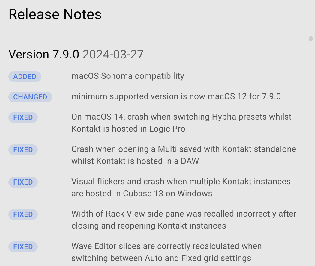

Here are the release notes from NI's web site:
I am speculating that Kontakt 7.10.1 is actually 7.9.0 and only available to those of us who had installed 7.10.
However, when I click on the Release notes from inside Native Access, I get this:The currently available software version is 7.10.1. Please make sure that your installation is up to date.
