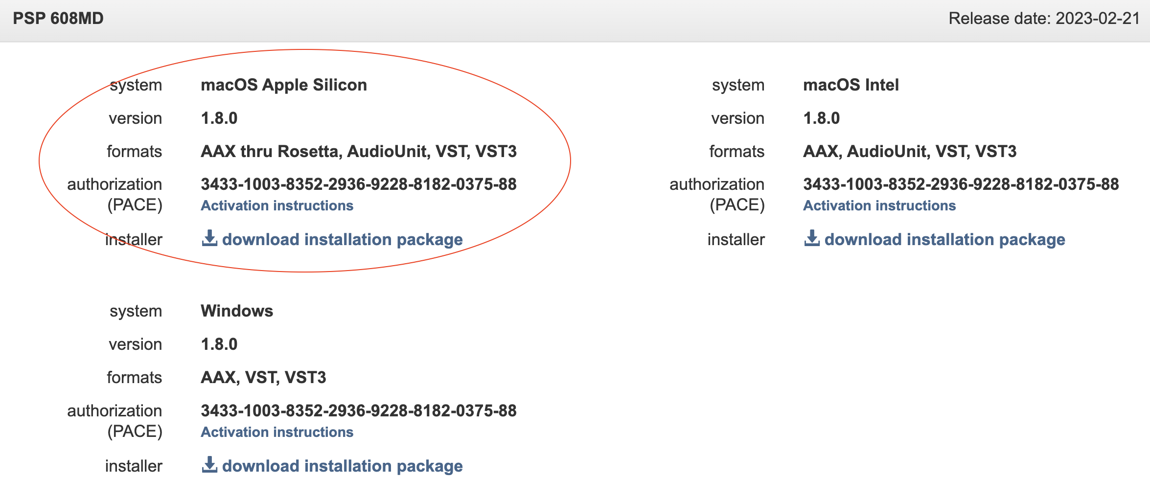

This package installs an AU, VST2 and VST3. The AU does not work on my system but the others do. Only the AAX requires Rosetta 2.

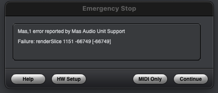

Just checked Absynth... and it was pretty good. Did some clicking around just now in Hybrid 3 and one of the menus shut down the MOTU engine. Just took a look again and the presets menu works fine and seems stable, but if you click the Parts Presets and scroll it shuts down MAS with this error:Last question if you don't mind. I'm currently able to run Absynth, Hybrid 3 and Loom II in AU as Rosetta plugins in DP, Live and Reaper etc. but they do not respond GUI wise, mostly Hybrid 3 and Loom II do not allow you to change setting via drop down menus, which of course is far from ideal. The only DAW or situation here that works is Bitwig, which only uses VST and came up with their own non Apple Silicon VST2 plugin hosting solution, the drop down menus work there. I have Unify and although it can also host non Apple Silicon native VST2's, they still have the drop down menu issue. Anyway long way of asking if the VST2 plugins hosted in KK as an AU are capable of using their drop down menus? Hybrid 3 for example?
So definitely not stable. For my purposes I really don't edit presets and I load the presets via the NKS support library so I'm not clicking the UI much, so I guess I can get by. Gonna try Blue Cat PatchWork... hang on...

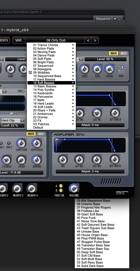

Well that's not good. This is what I get loading Hybrid 3 AU via PatchWork. The second level of the popup menu hides behind the GUI. Although if I click the spot where the menu item would be it loads it. Ugh.

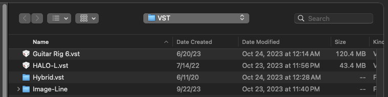

I just tried to load Hybrid into PatchWork as a VST. It wouldn't load and curiously (see below) it appears as a folder rather than a VST plugin. Not sure why that is and why KK 2.7.2 doesn't have a problem with it. I may need to reinstall it and see.
