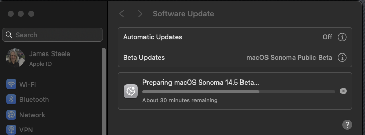

- Posts: 22802
Re: Sonoma 14.4 crash/kernel panic/reboot with Kontakt 7
Yeah... call me crazy, but I'm doing it. So annoyed tonight. I think 14.4.1 did it, but before every Steinberg plug I had that was UB2 worked. I think something happened after 14.4. Whatever. So I'm fed up and chancing it.
