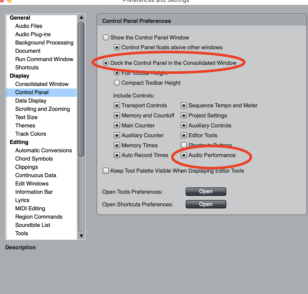

Here's how to set up DP to show that window.

If you do not have the Real Time meter showing, see my earlier post on one of the ways to display it in Settings/Preferences (there are other ways). This lets you see the problem in real time.
