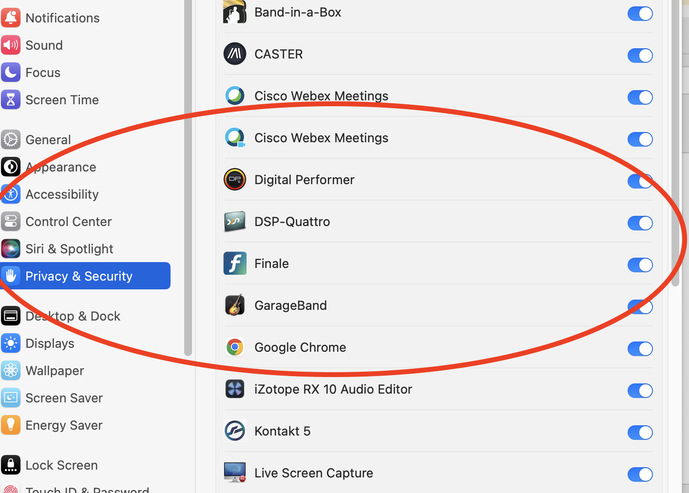

I suspect that you need to enable the Microphone in Privacy and Security.
In the old days, this was done automatically but Apple now requires it be done by you. You probably saw a notice about this and dismissed it—most of us did till we learned that all audio apps require this.

Thanks, Mike, but I already checked that and it's not the problem,
