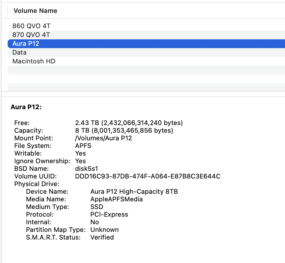

Yea, I thought so, too. Over Sonoma, it doesn't mention TRIM one way or the other but neither does the internal storage nor did the OWC TB3 housing. I was on a different call with Apple when I asked, "Oh by the way…?" Here's where you would see TRIM on another drive
I still have my SATA III SSDs connected over TB2 and they do give the usual TRIM Yes/No message.
I've attached a screen shot. The Mac sees it as TB3 — I suppose there's nothing in the firmware to tell it differently.
As for the Up to 40 Gb/s spec, remember that this includes about 25% overhead for video and that b does not equal B. It works out to the normal 2800 GB/s advertised be everyone.

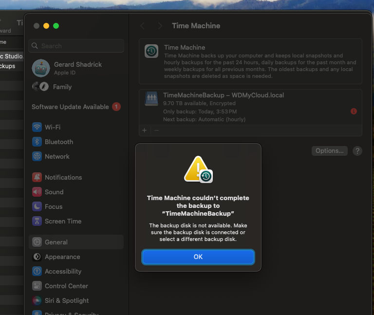

I solved the issue with My Cloud not recognizing certain external drives connected via USB. Turns out WD My Cloud will only play nice with external USB drives that are 16TB or less. The 18TB Dell EMC Exos was recognized by My Cloud once I made a 2TB and 16TB partition (it won't recognize WD HDD that are larger than 16TB either). However, I did the happy dance a little too early as far as successfully completing a Time Machine back up to a WD 16TB Ultrastar USB drive. After letting it run for 5 days (back up was 9.7TB) the resulting xxx.sparsbundle could not be opened by Time Machine and the USB volume would no longer perform additional incremental back ups to it. I Re-formatted the external USB drives again (both the Exos and the Ultrastar) and restarted the Time Machine back up ussing the Exos 16TB partition connected to My Cloud and will see if I gave better luck before I throw in the towel on this option for real. Will report back in another 5 days or so. Although at the speed it's going right now, backing up 9.7TB to the Exos may take closer to 2 weeks. It's taken about 2 hours so far to just back up 78.89GB of data (it's currently 2%). It's definitely running slower than when I tried the first failed back up to the WD Ultrastar. At this point, I'm ready for BlackBlaze to just take my money and sign up for yet another data/storage subscription.
