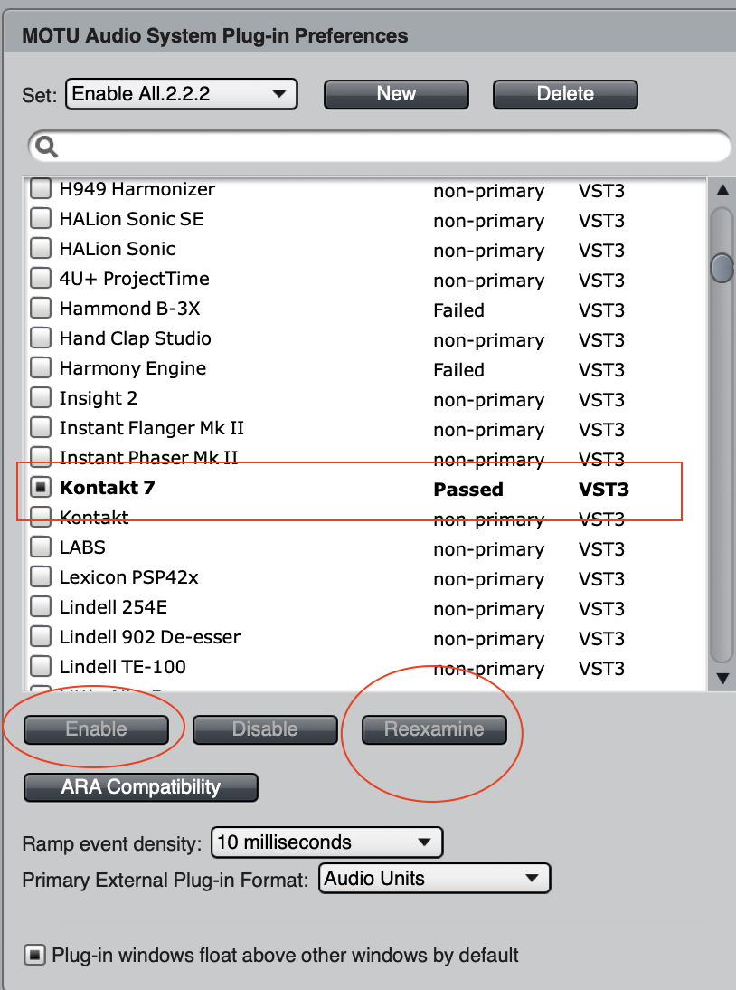

Did you shut down and reboot as I mentioned earlier? A simple reboot doesn't do it with Kontakt.
If you've done that and Kontakt still doesn't load, Open Preferences/Settings, select Kontakt under VST3

Hello Mike. Yes, I did a reboot putting the Mac in safe mode to rebuild the caches. Kontakt VST3 is still not accepted. I also gave both Kontakt and DP full access to the disk (on an article on the NI forum it was recommended to do this action) but I still get the error from DP that it cannot be accepted. In the AU version I don't have this problem.mikehalloran wrote: ↑Mon Dec 25, 2023 7:41 amDid you shut down and reboot as I mentioned earlier? A simple reboot doesn't do it with Kontakt.
